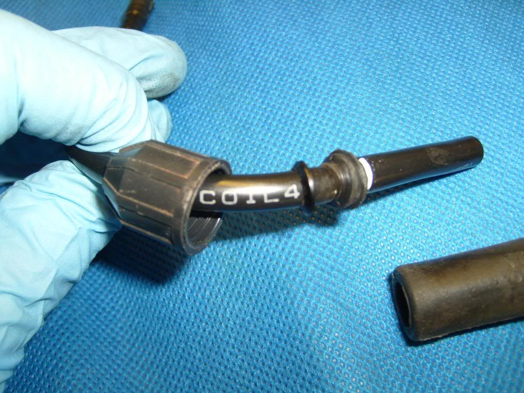

IF anyone fancies upgrading their old HT leads its pretty easy as the coil end of the lead is a compression type of fitting as below

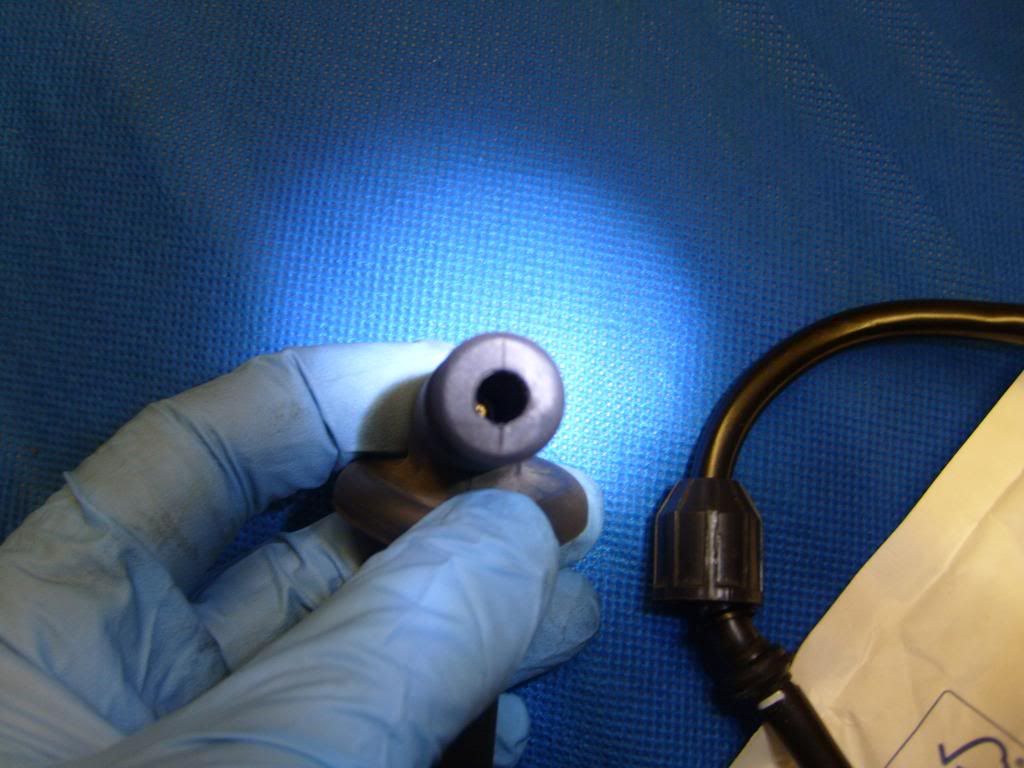

and the plug end is a screw in fitting, you can just see the screw in the bottom of the plug cap in the picture below (5 complete 360 degree turns and they are ready for use)

Hope this helps someone.
Karl.
