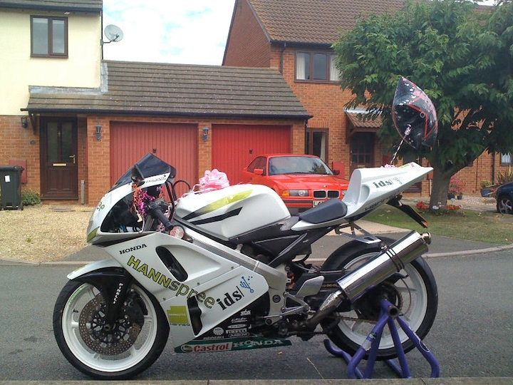

I turned this
into this
For the Mrs bday a few years ago now! there was a choice between an rvf in Castrol colours or this blue telifonica vfr that was ruff! i wanted her to get the rvf but being female she liked the colour of the vfr an that was that!

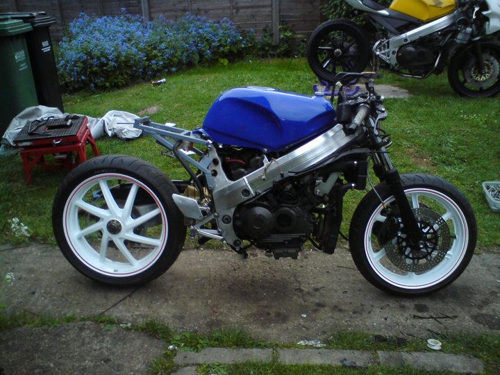

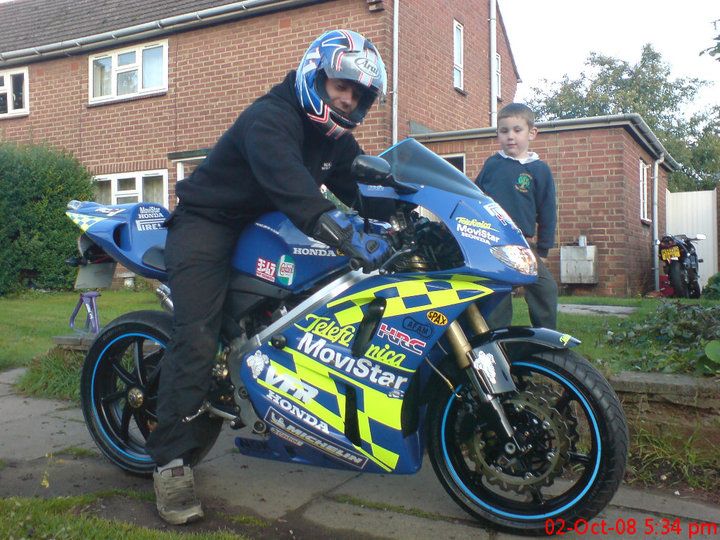

Heres the bike when it was picked up
the vfr court fire after 7 miles. never seen such a crappy job on a bike! they had made there own underseat pipe an taped the loom to the exhaust an cut the seat foam to clear the pipe. so it set fire to the seat foam an melted the loom. it wasnt the only problem. they had fitted sum usd forks from a ninja or sumfin along those lines an had cut the fork stem an only put 3 tacks of weld to hold it together. i ended up pretty much puttin it back to standered other then the Tyga Kit. My friend already had the tyga kit so i made my own sumframe from copying his. The fairing had been painted using Dulux lmao so they took sum rubbing down as it all had to cum off as it reacted to the primer. Once i finised the bike for her birthday (hence the ballon an pink bow in the pic) She got to ride it for about 6 weeks then found out she was Pregnant. So i ended up riding it untill i kinda broke it! Bottom end in motor went! A real nasty knocking noise
ive found another motor but would like a decent exhaust to fit to it as the 1 fitted was made up from the remains of the butchered under seat pipe an my friends old pipe as he replaced his with a tyga system.
