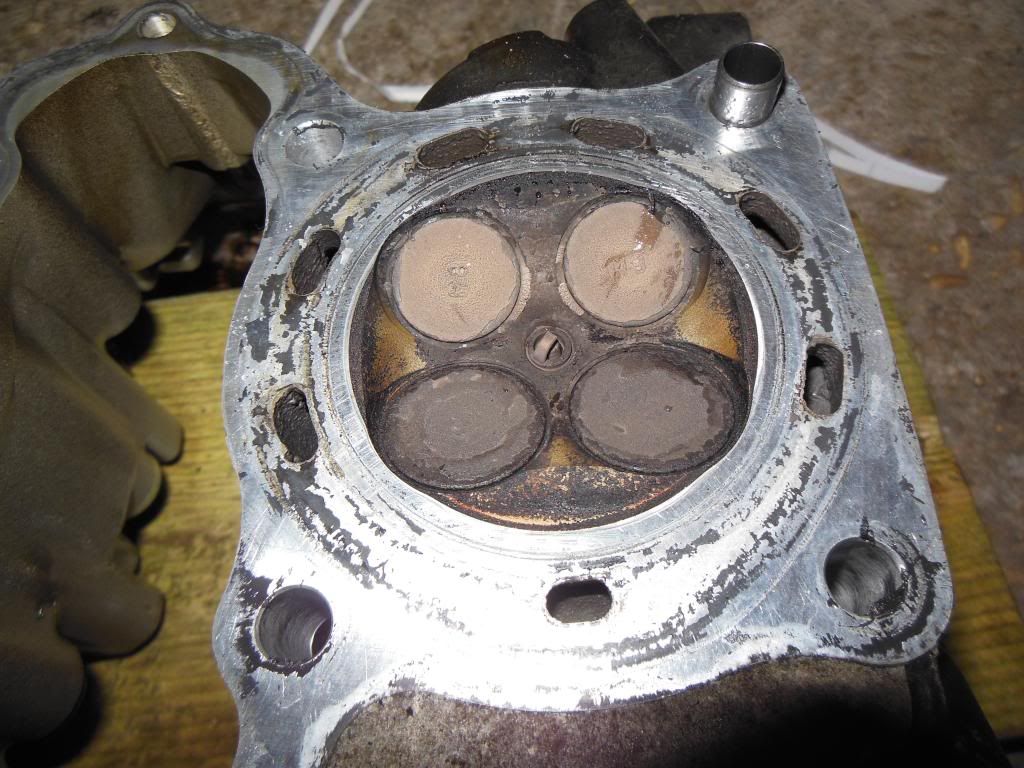

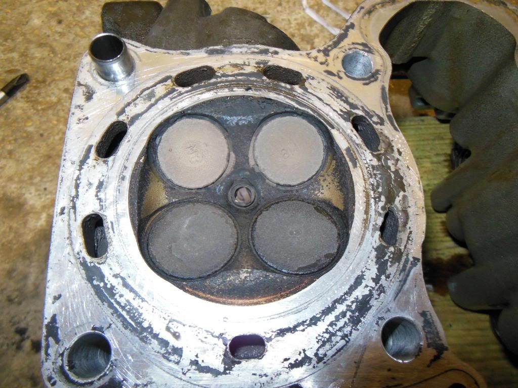

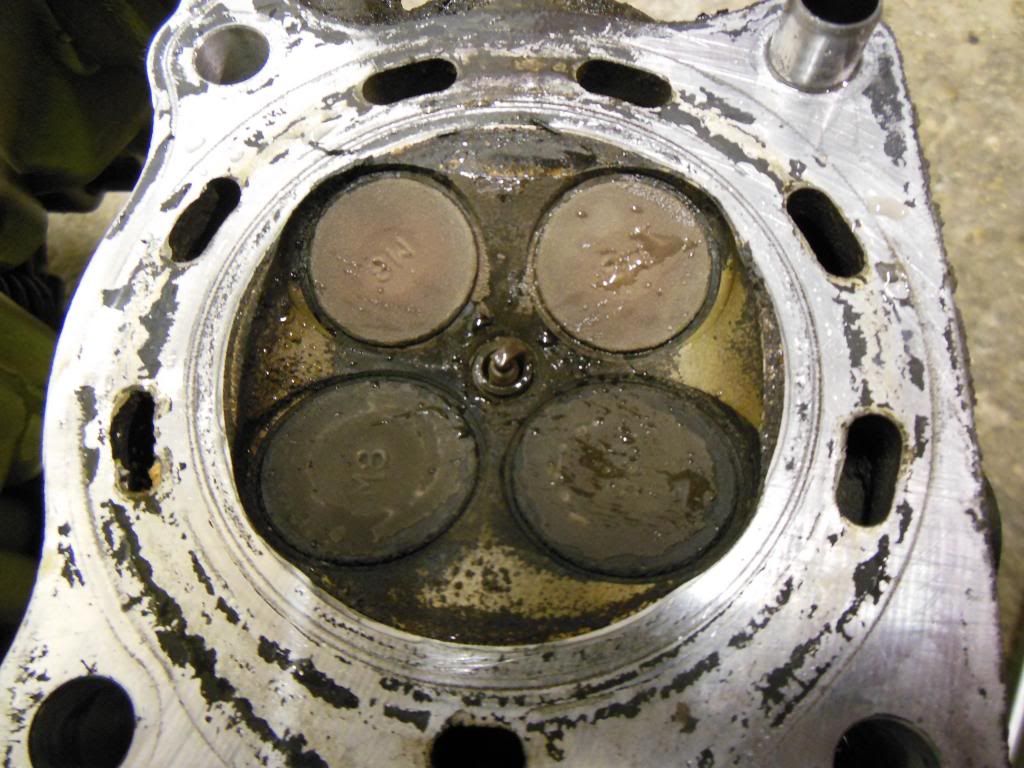

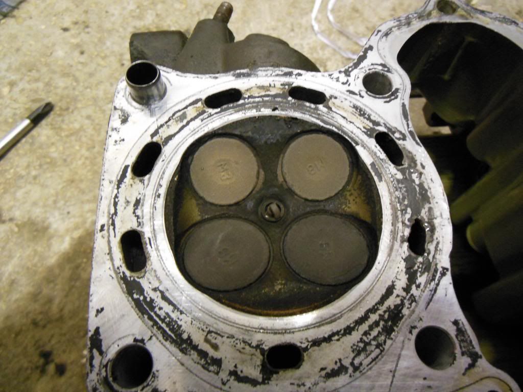

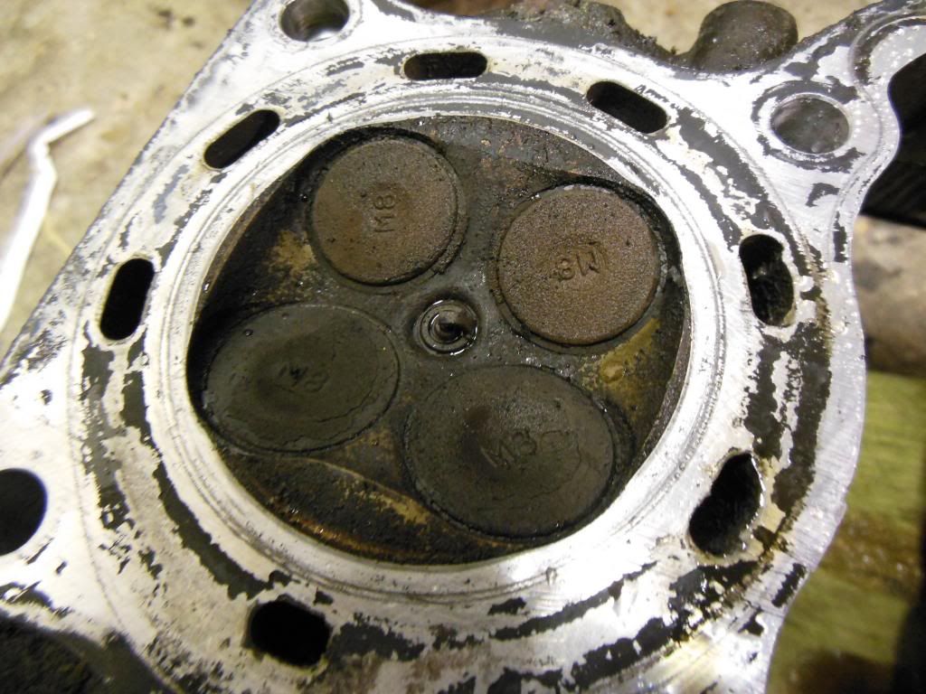

Any help with this will be apreciated, i will also upload a few photo's of the valve faces as i have now taken the heads off so hopefully there will be a giveaway there.

Pictures:
Theres a fair bit of carbon buildup around the valve seats so im thinking this could be part of the problem?
- Posts: 7166
Re: Strange valve clearances problem.
They do look a bit scabby eh? Get them lapped in and it will close the clearances up some more. You might want to get the valves checked for length too.
The usual closing of the gaps is normal - the valves are smacking into the seats pretty bloody hard and it causes them to recess.
