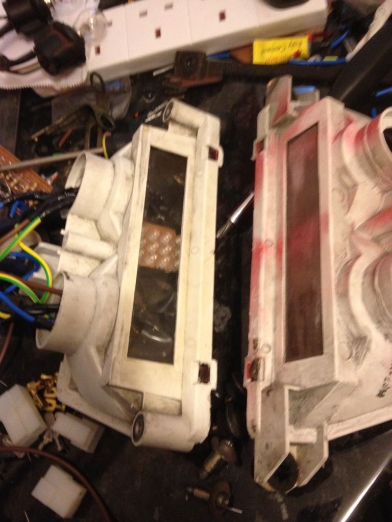

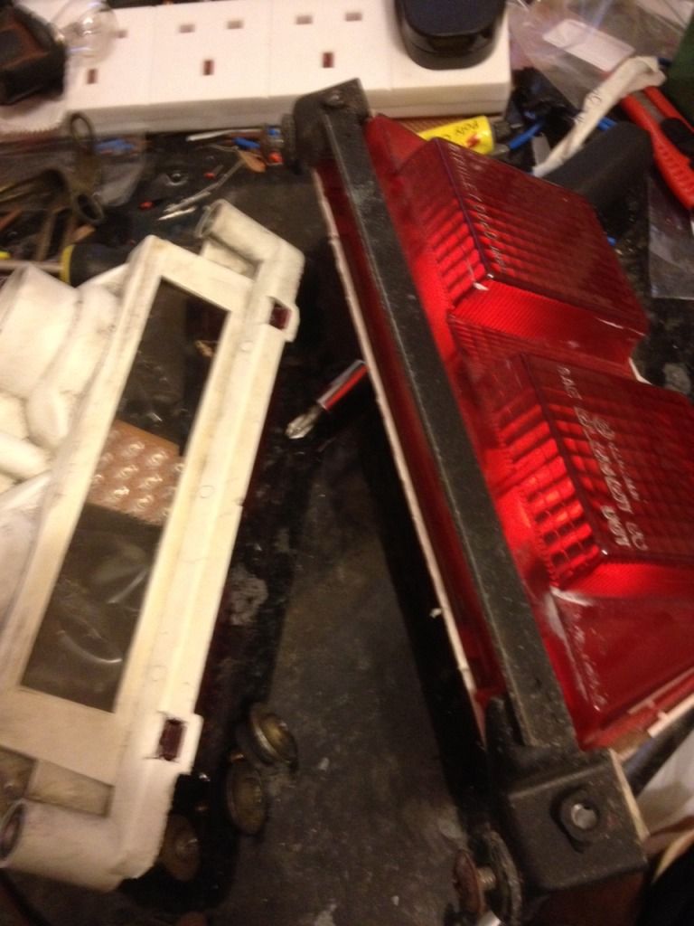

I'm doing a mod to my rear light unit and used my spare one to mod, only to now notice when going to hook it all up that it doesn't have the same fixings as the one currently on my bike.
Piccys to explain:
The metal bracket is the only thing holding the rear light unit in place on my aftermarket fibreglass fairings, so it's kind of needed....
Did anyone know there were two different types of light unit for the NC30?
Plus can anyone help on how to fix it up without tearing apart another unit?
Piccys to explain:

I could be wrong, but I'm pretty sure that what you have on the left is an NC35 unit, and the other is an NC30 one. The fiche isn't too clear, but the NC30 has an arrangement with the long bar under the unit, the NC35 doesn't have this bar but has two brackets that mount either side instead. I guess you could get creative, but it would probably be easier to look for another NC30 light instead..... The top mounting lug on the light units appears the same if not very similar, but I'm not really sure how the bottom half of the arrangement compares.

Aye, your modded one is an NC35 unit

Bottom left of bottom pic and a bit above on the left edge - is that both halves of an alternator connector I spy? If so, where did you get it from?
