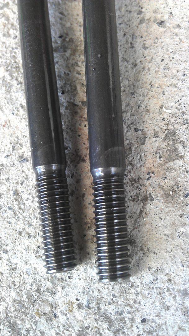

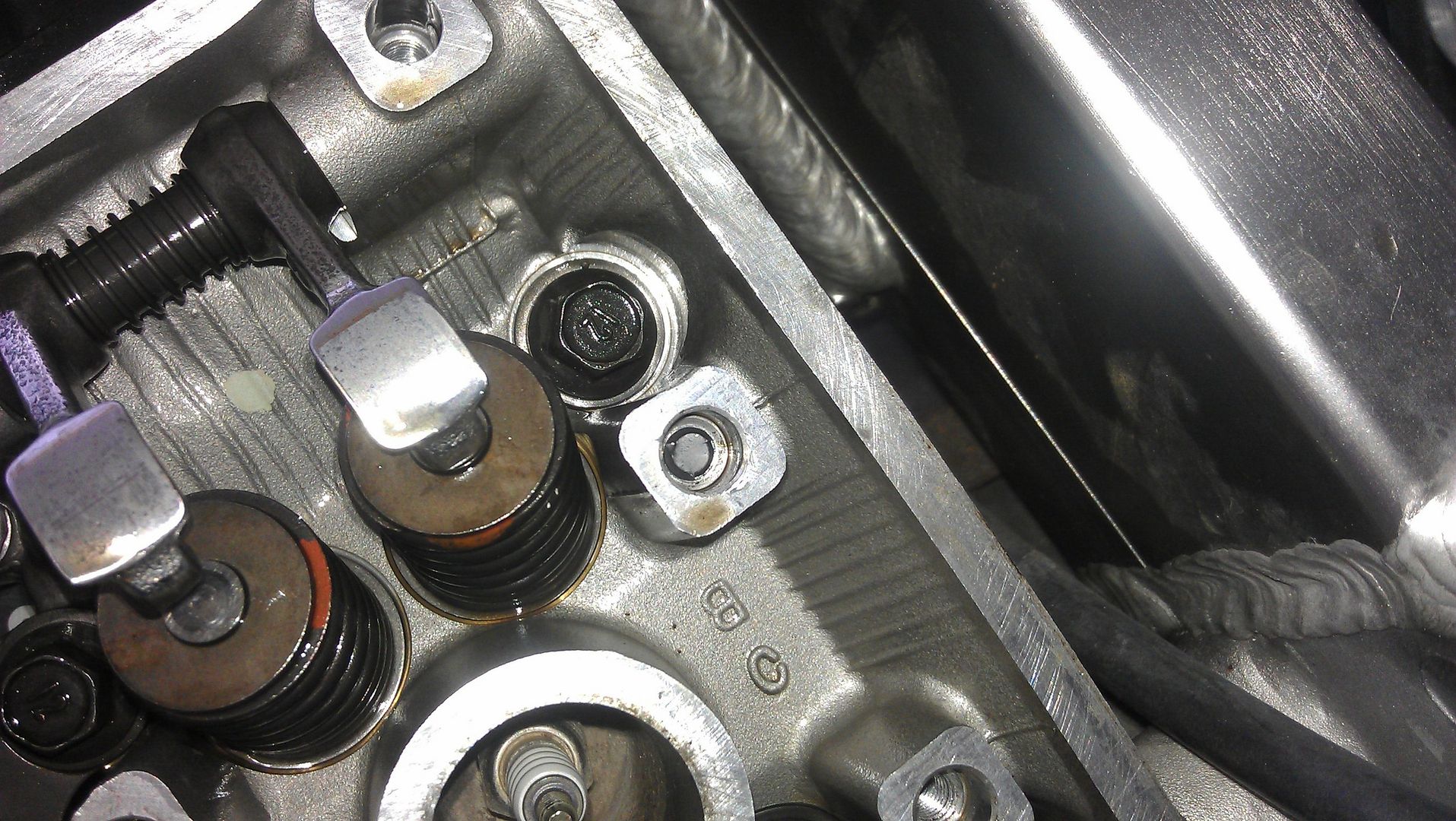

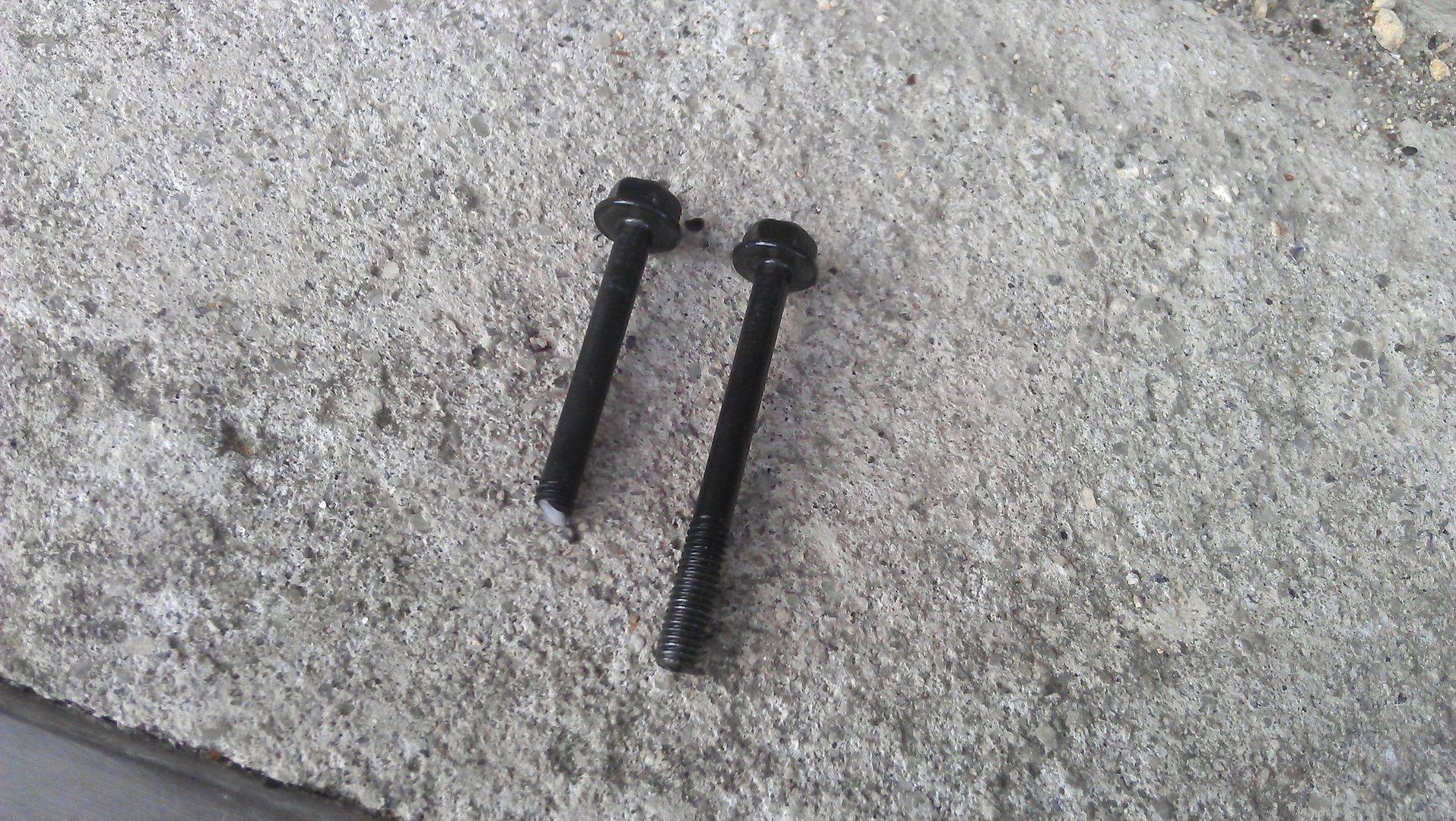

Long story short, i know what a tearing bolt feels like now.
Was using a brand new torque wrench and hadnt reached its setting yet.
Luckily i stopped after that because i noticed 2 other bolts were going too after taking them backout.
Pix:
http://i143.photobucket.com/albums/r155 ... AG0116.jpg
http://i143.photobucket.com/albums/r155 ... AG0119.jpg
http://i143.photobucket.com/albums/r155 ... AG0117.jpg
So what the cluck now?
Is there ways to get this out or is the whole block doomed?

Broken bolts when tightening are easier to get out than those breaking on undoing, as corrosion can then be a problem.
Drill a hole on the centre and tap a small Torks bit in, and gently try to undo it.
Check the torque wrench calibration [against another, were you using kg-m, and not foot /lbs?]

Just take the heads off and get some grips on there, you could try some easy outs, but personally I've not had much luck,,

If they break easily, then change them all, sounds like they have been over tightened at some stage and are now stretched and waisted.
Have a close look at the threaded part that lines up with head gasket to see if it looks waisted.
