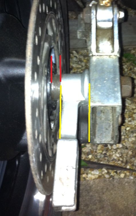

I know I'm doing something daft, but I can't seem to fit all the bits from the rear wheel back into where (I think) they should go.
On the right, the spacer (lined in red) sticks out a fair bit, but does seem to be in as far as it will go:
The yellow lines mark the disc mount, which I've swung round in the pic to get it out of the way.

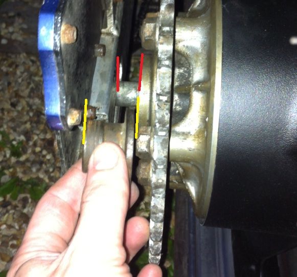

On the left, that doesn't leave enough space for the spacer (available space in red, section which needs to fit in it is marked in yellow):
In the pic, the spacer is rotated by 180 degress - flange should go the left and rest against the swingarm - I can't describe why I've taken the picture like that
Neither side seems to have any places where one of the bits should slot in, but I suspect maybe the spacer on the right should stick out a little less than it is doing.
Can anyone see what I'm doing wrong?

That large spacer in your left hand is the wrong way round (perhaps you knew this) the large flat part goes up against the swinging arm, the smaller end of the spacer actually goes into the seal in the axle

Cheers bikerbiffo. Tried keeping it straight, can't quite get it in yet. I may need to grab my brothers assistance.
Superjack, I know it's the wrong way round (not sure what I was thinking when I took the picture). How far should the laft hand spacer sit inside the wheel? My bearings are flush, and don't seem to want to move inwards, but I suspect Ive moved something, and that left hand side is my prime candidate.

It's a pretty simple assembly, if it looks right it almost certainly is. The spacers are different and you have them on the correct sides.
