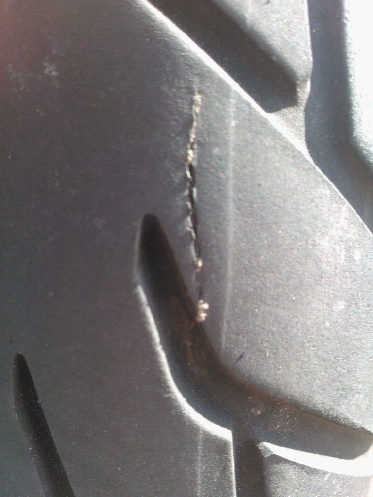

well the NC went in for MOT today and i thought all was well apart from the jobsworth MOT man,
he noticed the cords were coming out the tyre he said, i thought WTF its only done a few 1000s miles its well within the limit (4mm) well it turns out that there are cords are in the surface of the tyre in one small bit enough for him to fail it apparently, a cord was pulled out where the line is. i assume it could be just a few loose fibres not really cause for panic or concern that were in the mould, but its also 5mm near the compound change on the side walls see the dotted line of chalk i did,
pics attached, ps sorry for the repetative images its just different angles and light hopefully to catch the best the eye can see, this has to be seen by the eye really.

i have now emailed bridgestone, i also have there number and shall call to make sure this is at least looked into.
"I am seeking to speak with somebody from the technical or quality control department.
My motorcycle failed its MOT test today as a result of a CORD, the cord is in the surface of the highpart of the tyre which is 4mm high from the treads, I believe this to have been a loose fibre that in the mould has come apparent as the surface has worn down.
Consequently this has left me in a predicament as I need my bike and MOT but yet I feel this is a manufacturing defect and would like someone to take a look into this.

Here's a pic of mine on my 090. Probably only done 6 tank fulls of rides so loads left on it, but like I say this is coming through now just in one spot.

I had one of Engineer’s look at the pictures and they ensured me the tyre is definitely damaged and not safe for use. With motorcycle tyres, the cords are tightened and if a cord is visible it will not be a migrating cord.

Your engineer says there is no chance of a cord leaving the tyre if so why has the rubber got the cord twist pattern in its surface? why could i remove an inch long piece of cord with my finger nail? why hasn't the tyre blown out? Why when inflated to 60psi does the "cut" not expand?
Once my tyres arrive and this is removed ill fold the tyre where the "cut" is check inside for damage, and if you cannot collect the tyre from my house then i shall have to take matters with citizens advice consumer service.
