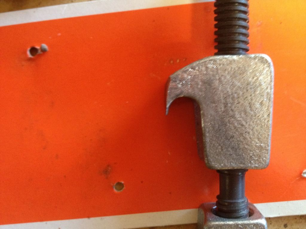

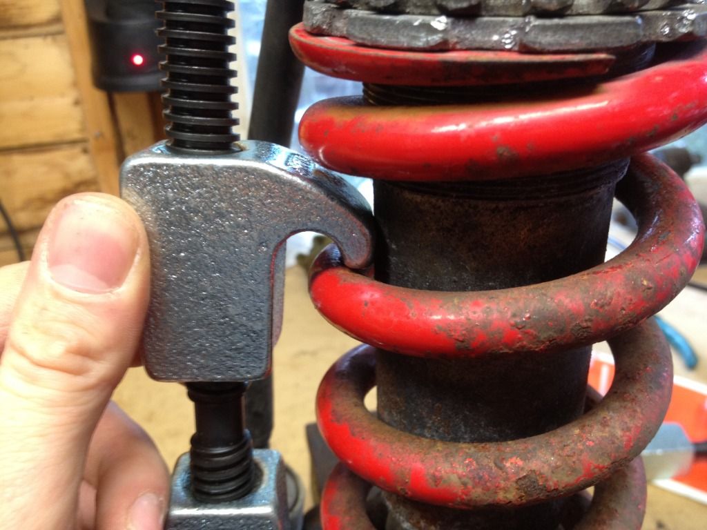

First of all I purchased some cheap Draper spring compressors from Autosave. (£25)
But they didnt fit so I buffed them down fo that they fitted between the spring and shock.

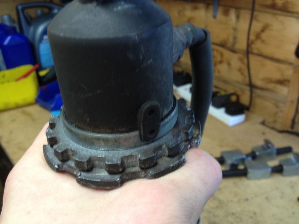

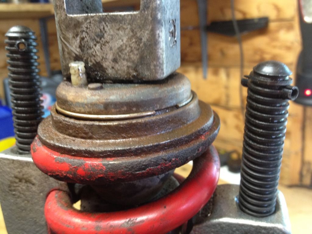

When i was pleased that they fitted and the spring would move freely when compressed, i measured the length of the spring. Do this before backing the preload ring off so that when you reassemble you can set your preload back to the same place. Once you've done this grip the bottom of the shock in a vice with a towel. Compress the spring then back the preload and lock ring ring to the top of the threads.

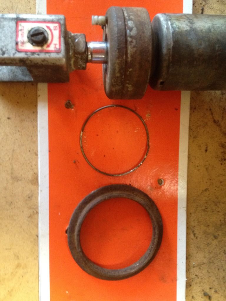

Then flip the whole lot over and you'll see a cup and collar ring that the spring sits on. You have to separate the ring from the cup so spray a bit of WD40 on. Then give the collar ring a chap down to expose a circlip round the cup (mine was siezed bad and was a bit of a pain).
Then whip the circlip off and the collar ring will come off allowing the the spring to be removed from the shock so that you can clean it all up or whatever.
