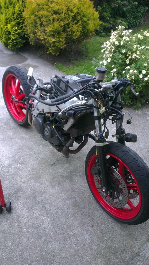

I'm Chris, 19 from Cornwall. With some help from a few guys on here, I got this NC30 in May '11. I got it locally for just over £1000, it had no service history, about 5 previous MOTs, and unknown to me, a few problems.
As soon as I got it back home I started stripping it down to see how it was underneath the fairings etc, and some of the sights were not pretty... Lower radiator knackered, exhaust system welded together (terrible job) with chemical metal used on the bottom joint, rear caliper and grub screw seized, airbox had holes drilled in it etc.
As I went through fixing the problems (with my, at the time, non existent mechanical knowledge) I seemed to unearth more problems...
Anyway, so it has been mostly fine since then, I did have to change the reg/rec and the battery, but that was about it. Once the garage was free for me to use (dad used to use it for his business), I got it inside and did a bit more work
This allowed me actually get on with stuff, instead of waiting on the weather. So I did my valve clearances, then cleaned, re-jetted the carbs (118/120), raised the needles, drilled the slides, stripped the paint from the yoke (it was horrid..).

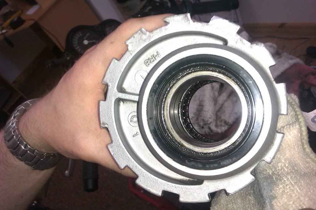

Next was the chain adjuster, it was completely seized, with a lot of ruined teeth, so I got everything out (with relative ease surprisingly) and found a load of gravel. So I got all that out and sorted out the hub as much as possible.

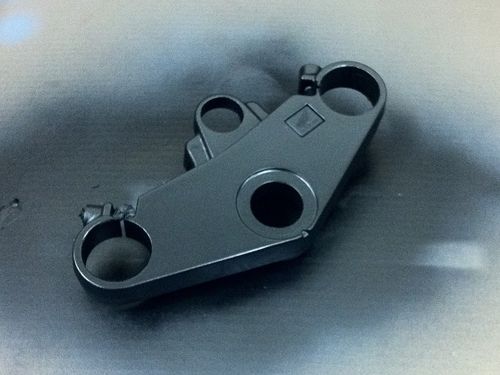

Had my first go at painting something myself for the first time, sprayed the yoke in satin black, came out pretty good if you ask me (the way the light is shining on it makes it look crap!)

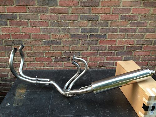

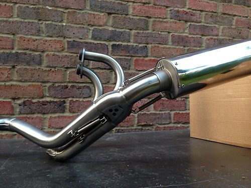

Also got hold of an exhaust system, stainless TSR half system, standard (I'm guessing) front pipes, and an exhaust I'm not quite sure on.

You got the exhaust system then! Looks good, was very tempted myself.

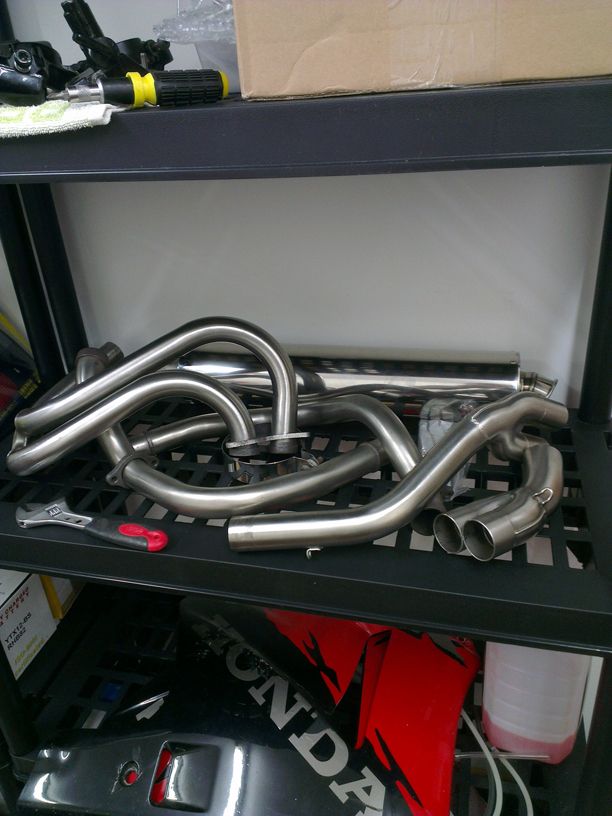

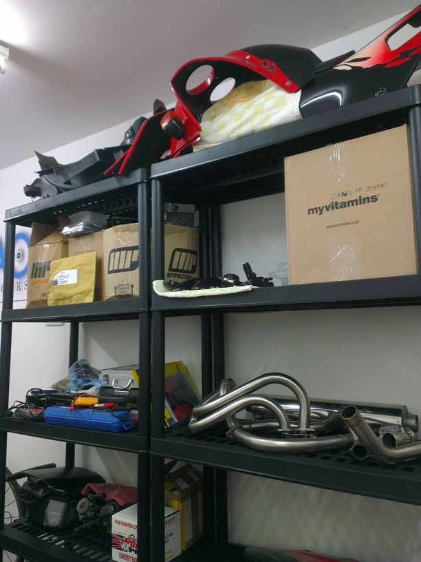

Yesterday I bought some shelving units for the garage to put all of my bike parts on, because apparently the place was a mess (yeah right, an organised mess, I knew where everything was until people kept moving it!), so that should keep everyone happy.
Received my exhaust yesterday, just what I was after, great condition.
Started stripping the paint off of some parts yesterday, so they should be ready for priming today if I can get round to it.

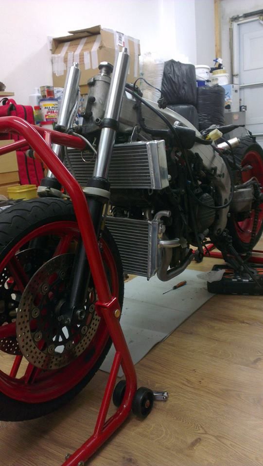

Progress has been a bit slow recently, been quite busy with work.
Received some of Geoff's Chinese Rads (Cheers Concrete Jungle
) Did a quick test fit, had to bend a couple of brackets to get it to fit to my lower radiator mount, but other than they seem ok.
Quick question, I'm not sure if it was before, but it seems that when I fit the lower radiator properly, the fan bracket is pretty damn close, if not touching, my front downpipes. Should it be like that?
*edit,^ nevermind, just had another look at the radiators and I just didn't have the radiator tightened up properly. 'Tis fine now.
