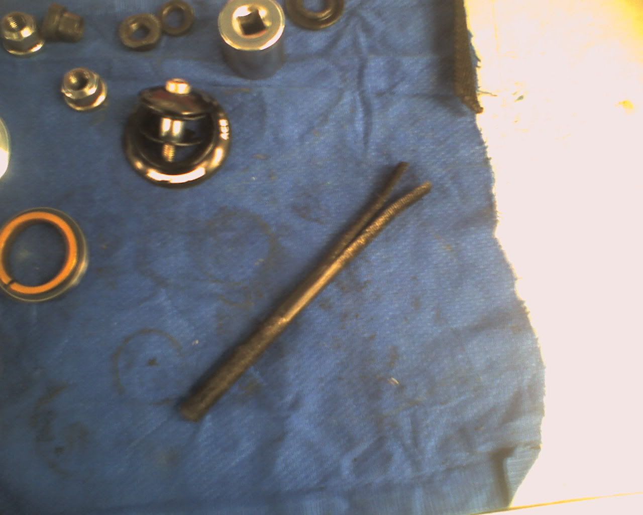

Re: Dog link bearing removal
I made this at work one day from an old 10mm wheel axle I had knocking around. I needed a drift to get some cartridge bearings out of a hub.
Sorry about the quality of the photo. I just cut a slot down the length using a hacksaw, and then flared the ends out a little. It works by drawing the whole thing backwards through the centre of the bearing, and then the two halves spring out behind it and give a nice even contact with the bearing face for you to tap it out. I wonder if you could make something similar out of a suitable size of bolt or rod? Just a thought.
