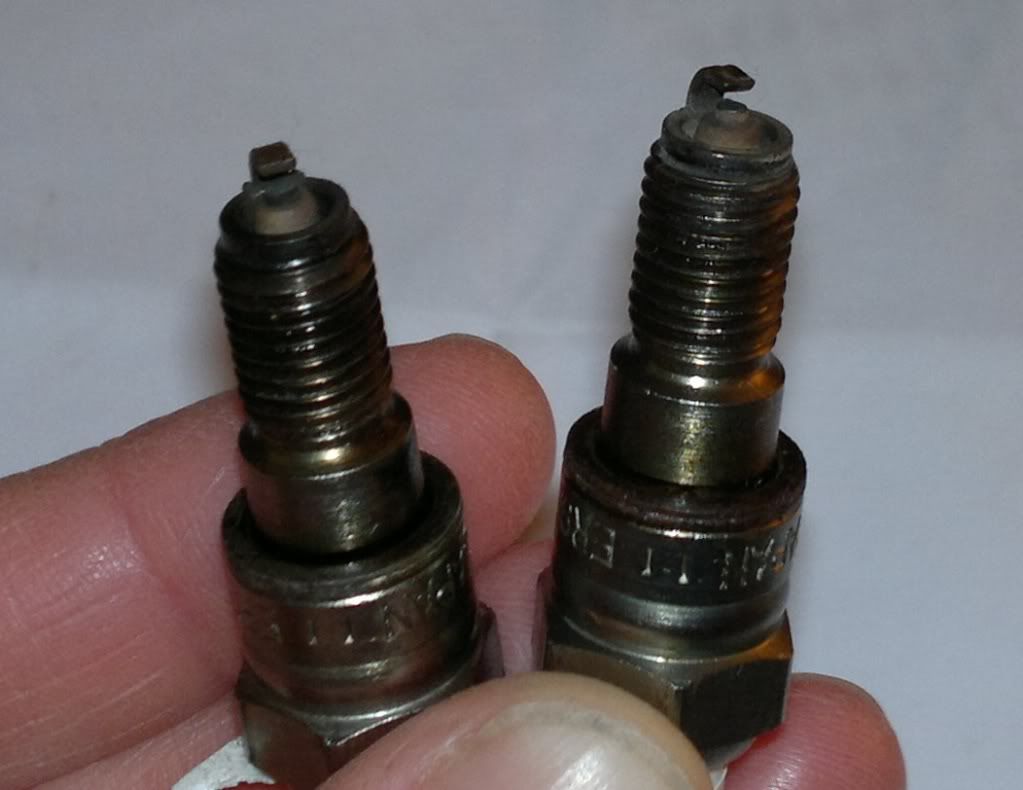

Plugs for 1 and 3:
They look ok to me? I think 1 is running hotter than 3, the insulator on 1 is off-white, while 3's is light brown. There was an oil/petrol mix at the bottom of the thread/collar, just above the plug gasket/washer, but the tips of the plugs are clean.

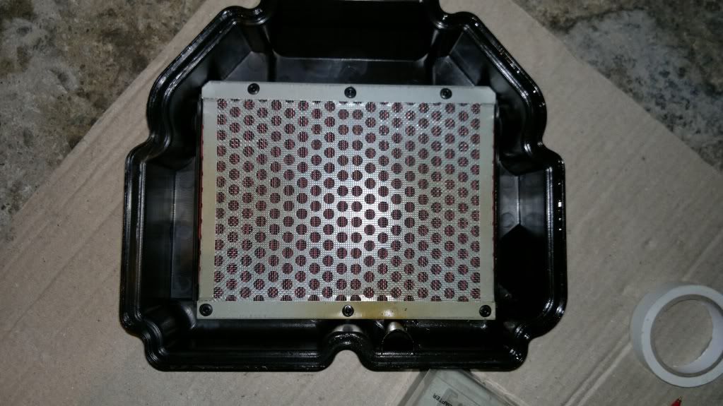

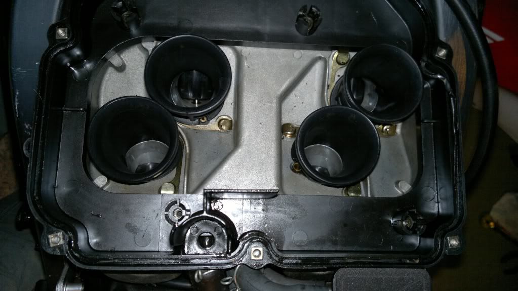

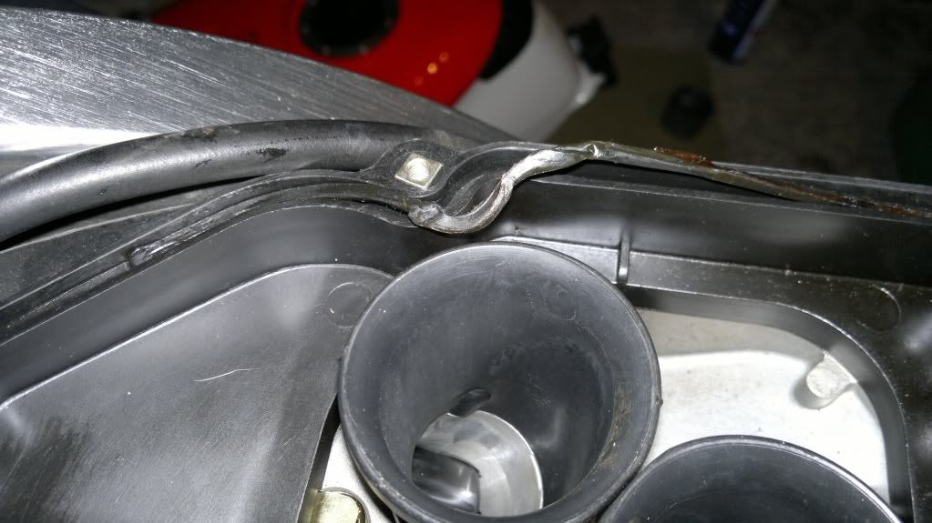

The airbox and filter (which seemed quite clean) did contain a little oil (assume from crankcase breather?), and part of the airbox gasket was slightly mangled and so not sealed, shown here:
I shouldn't have thought this would affect running? I'll try to get access to 2 and 4 tonight, and hope my plugs arrive in the post today. BTW, does anyone actually bother to set plug gaps these days? I thought they came set to the optimum gap, and once they've been used the electrodes get pitted so it's pointless doing it anyway?

You don't need to set the electrode gap.
Are the carbs clean (proeperly clean) and properly adjusted? (float height / idle screw)
When did you last check your valve clerances (with the carbs off it's a good time to do)
I'd check the carbs have the right jets and emulsion tubes, reset the float heights and pilot screws, ensure the pilot circuit (3 tiny holes to the butterfly) are spotless on all carbs and re-balance.
If they and the clearnces are fine theres no reason it shouldn't run perfect.
