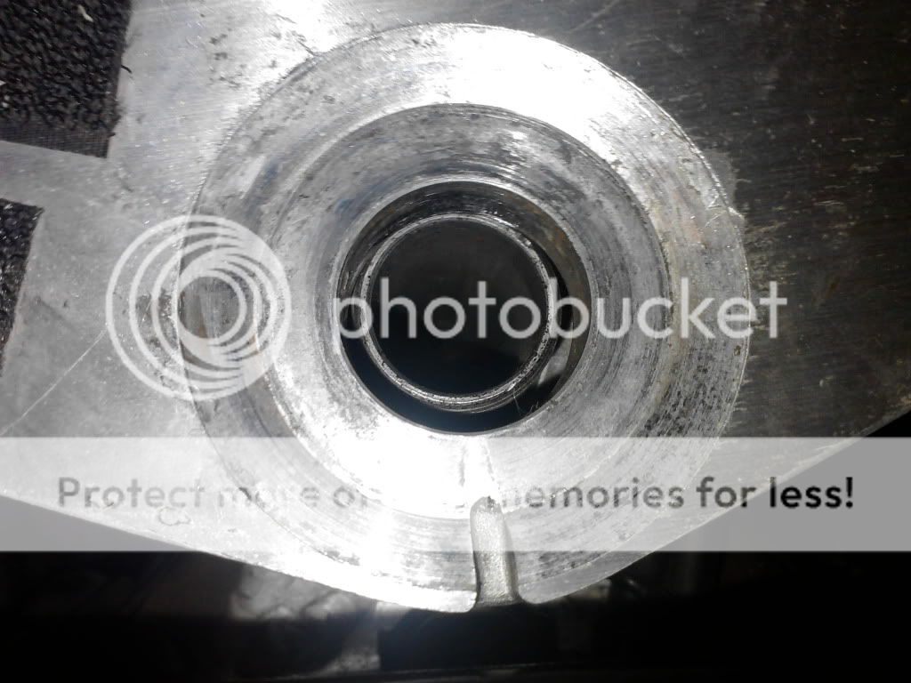

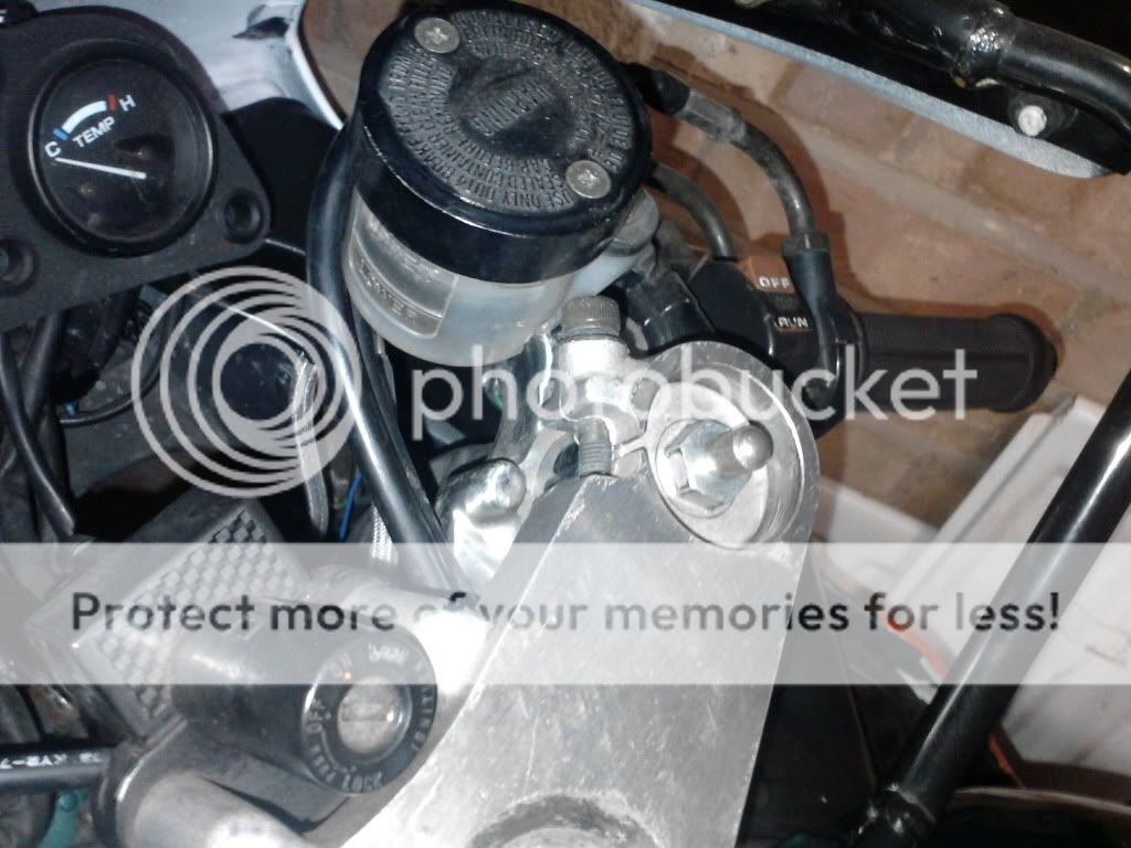

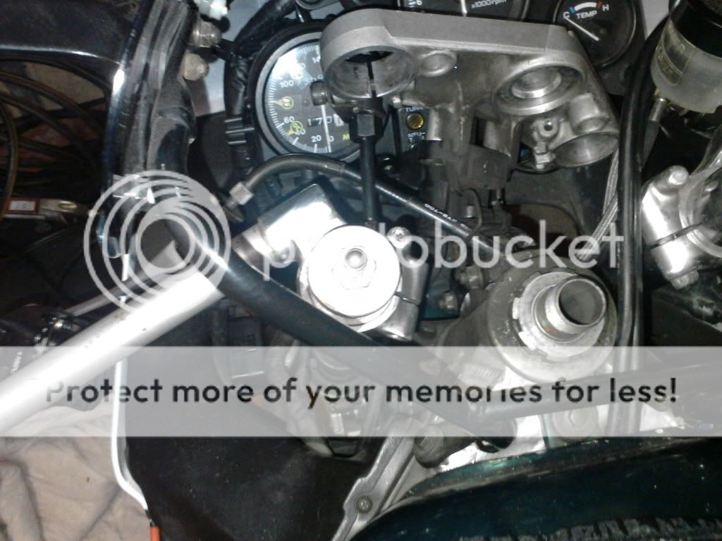

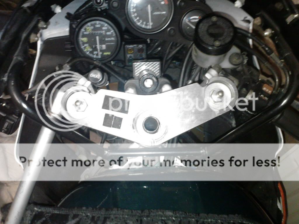

- Posts: 422
- Location: West Midlands
Re: Replacing a clip on - help for an ejut pls
this is what i meant about lugs, you can see the hole in the bottom of the yoke for it but the lug on the clip on isnt in the same place, dont seem to be on the wrong side either as if you turn it round its the wrong way.
this shows where the lug sits on the yoke now
if its not a problem then i will just leave as is to save the hassle
what i am having a problem with however is getting the yoke back on, it does not slip on.
you should see on this i cant line it up
here it is a bit closer, it cathes on the top of the stem thread.....
any ideas? if i undo a bottom fork clamp, it wont really help me will it? i need to undo both but cant as the bike is only on a rear paddock stand.
