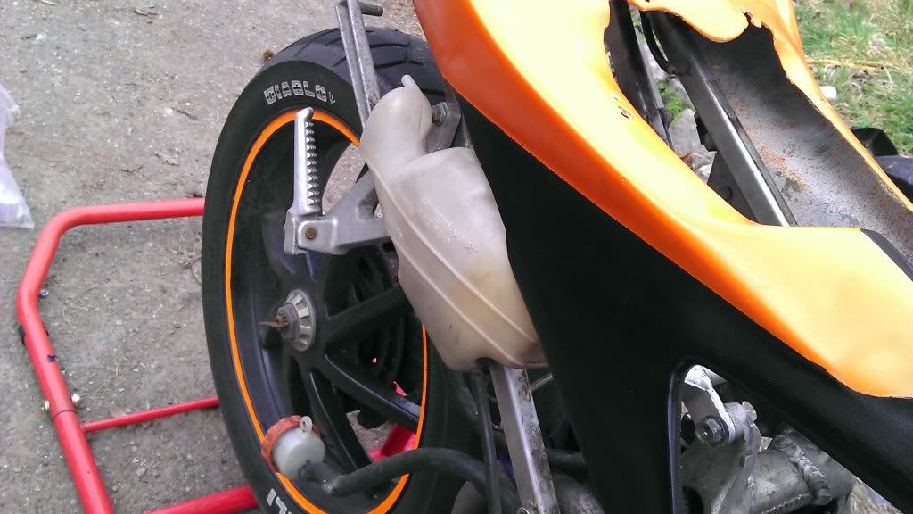

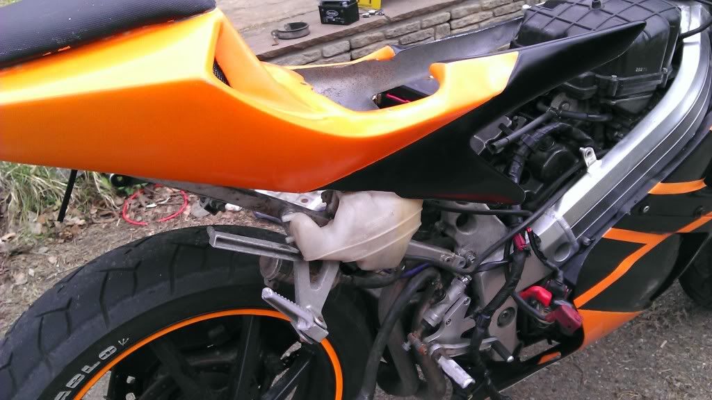

okay, so i wanted to properly fit my k-con tail unit, but im running into a series of problems....first of all... the bloody coolant reservoir is blocking it... there is no way i can get that tail unit over the reservoir.... what do you guys suggest i should do? can the bike be run without a reservoir? if so, it is risky?
im sure someone with a conversion tail unit, who has installed it on their bike, can help me overcome this problem?

Re: K-conversions tail unit problem, anyone help?
Bin the standard header tank and fit the hrc one up front
