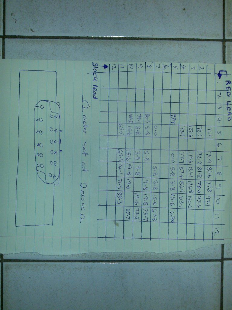

For those of you wanting to check the resistances of the 12 pin SP box use the table below.
Values will be slightly different between boxes but should be close.

Cheers for that Valve, im sorry i wasted your time though
