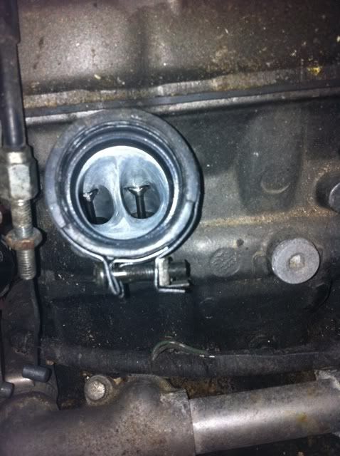

Funny you should mention the oil cooler was looking at that yesterday and to be honest after reading the akhara site info on it it looks straight forward enough, BUT, i have micron headers from the front so straight pipes that wont give me clearance so i think its a bit of a non starter, still got a water pump cover and 600 oil cooler in watch in ebay tho.
Inlets are fully fettled,
Not done by my hand tho, not gone any further into the engine apart from checking the valve clearances.

Oh and all that shit and grime in that pic has long since gone!!!
