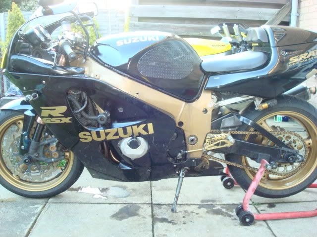

Here's a pic of the srad with the conversion just for pic whoring;

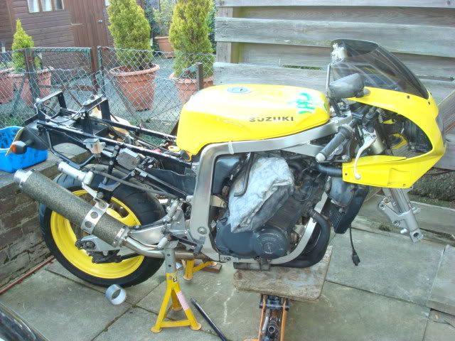

And a pic of the 400;
