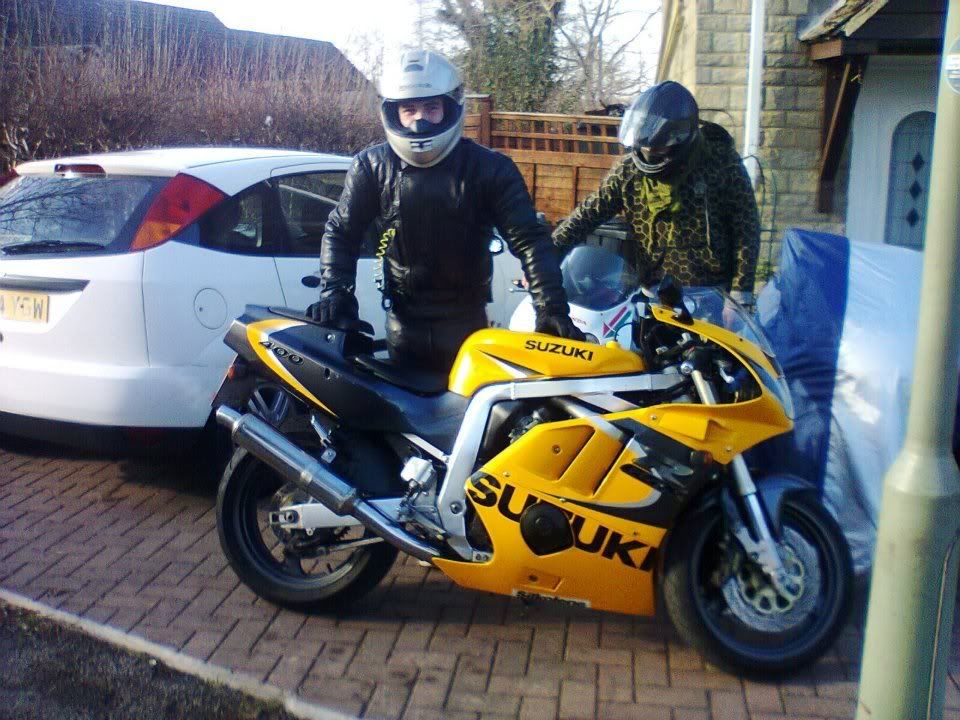

Bit of info about the bike: its a 1992 H reg imported in 1999 with roughly 6000 miles on the clock sold in 2000 and all 5 owners have been within 30 miles of my home town. It has all old MOT's to back up the current mileage of 9000, dream machine paintjob looks like the yellow and black GSXR600's really genuine clean bike, carbs where ultrasonicly cleaned a few months ago with new o-rings. Only thing that lets it down are the discs and tyres we got it for 1100, chuffed to say the least :D heres a pic
My bro in front with the gsxr, me in the background with my NC30
