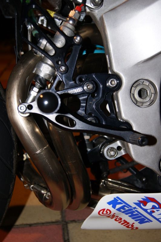

Looks perfect for the track , I have a set of those rearsets but I'm having issues with the rear brake leaver hight

Yep. It would be nice if the bolt on the bottom of the master were 10mm longer!

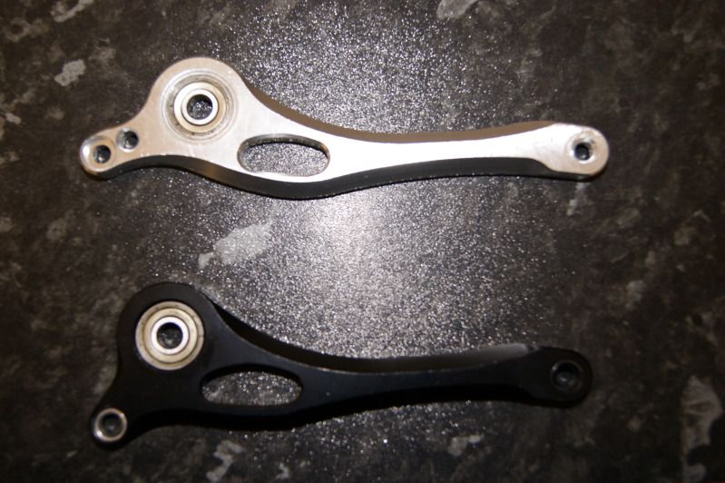

Guys you need to speak to Diamond Race Products and get this lever from them as in the photos I've taken tonight to get over this rear brake problem your having.marcus57 wrote:Looks perfect for the track , I have a set of those rearsets but I'm having issues with the rear brake leaver hight
Top lever is the new one well my spare and bottom one is the one you have.
This is the new lever fitted and it makes the shaft from the master straight to, mine needs alittle more adjustment as it's still a little low for me but I have loads of adjustment left with the new lever.
I rang them and spoke to a guy in the workshop and emailed him this pic explaining the problem and he sent me one black and one silver lever with the longer bit at the connection end as a replacement which worked.
Hope this can be of some help.
