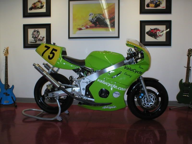

I have been having a 1WG with a 3TJ swinger (I believe) with a Built EX500 motor in it. I bought it like that as a guy built it for a specific class over here. But that motor has since blown up so I figured I'd get a 400 lump and put it back in as a back up. The Chassis handles like a dream.
Current specs of that bike are
1988 1WG Frame might have a 3TJ swingarm, yall will have to let me know that one
Stock 400 motor 14k miles.
FZR600 Forks with Traxxion Dynamics internals
Fox Twin Clicker Shock
NRC case covers
Going to run a Total loss
Full Yoshi system
Plan on installing a Factory Pro jet kit but don't know about the filter yet.
The plan is to send the motor to a shop that Specializes in FZR's and they will install a 490cc kit in it (spec regs for a race class here). Going to put out between 82-85hp with flatties.
This is it as the Hybrid.

First things first, the swingarm looks like a 3TJ although the brake's been mounted above the arm. It could equally be a 3en2 arm (the model before the 3TJ) which was your California SAC bike, I think. I guess this has been done to get a 17" wheel in the back.
More general stuff ... the usa model years are different to the UK and Japan ones, your 89 is actally a 86/87 Genesis model to us.
Your forks are 38mm dia (?) later FZR600's used the same type but had 298mm disks (yours are 285mm). You can look for a Foxeye or Thundercat front end which should drop straight into the headstock that wouls give you 41mm RWU adjustable forks and a 3.5" front wheel rim, the spindle dia is wider too. Depends on the rules I guess.
The biggest limit to breathing is the airbox rather than the filter. When a 600 engine is used is this that is the problem, but I guess with Flatslides on it you'll ge to a bolt on type ???

Forks are 38mm as of now so you are correct. I may upgrade it later but as of now these work very well so I will leave it for the time being. The Green bike has a 18" inch still in the back as of now. But that will change. As far as the flatsides go I will have to talk to Steve at Speedwerks and see what he recommends. If it is a pod system that's fine or if he advises an airbox I'm sure he can source one.
I will have a look at the F3 rim on the older model yellow bike swing and see what was done because I would like to have both bikes on 17" rears.
