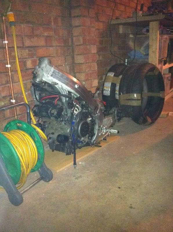

Heres what im starting with
just a bugger that iv sold half the bits that i now need.

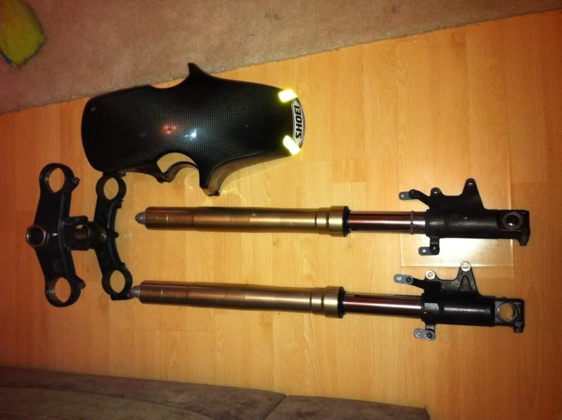

Massive parts haul going on at the moment , got abit carried away with the front end .
Also have a nc35 rear linkage , 600rr calipers and mc & some ebc prolites.

Looks like it will be well spec'd
Nitride coated forks?
- Posts: 1142
- Location: Taunton
Re: Nc30 track bike build
no there standard , tempted to get the outer coated black and inners nitrated and fit them to the oki , but for now they will stay like this.
