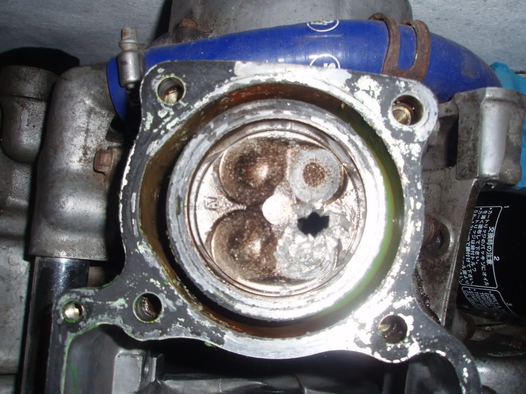

Afraid so - it's my RLR engine with the lovely knife-edged inlet ports. It made a very brief metallic noise as I entered hangar straight at Silverstone on Friday, then half a lap later another one and that was it.
Not entirely sure what caused it but I did stupidly knock it down a gear instead of up earlier in the day. Maybe I threw a shim or something. Either that or one of the valves just gave up.
Pondering what to do now. I either pick up a standard engine or break the bike and start again. If you see an Ohlins shock on the FS section you'll know which I did.

I feel your pain,looks and sounds so similar to the death of my RLR engine.
It's soul destroying.
Should have my new front head back from RLR next week,then a transplant onto my stock engine with my undamaged rear head.

Nice pic Dr Jones, a bit more useful for a post mortem than mine. Looking at yours, it seems to have lost the head from a single valve which has punched a hole in the piston - that pretty much confirms what happened to mine, i.e. the initial tinking metalic noise was a single valve head dropping.
Did you also accidentally massivley over-rev it or did it just go? I wonder if it's user error (like I think mine was) or a combination of HRC CDI redline and the engine tune and the valves just can't quite cope.

Post by Indiana Jones »
Most def user error.
Was under pressure holding my position and held a gear for longer,just past the shift light but not against the raised limiter,rather than shifting up and losing drive.
Next corner....dropped two gears like I had been doing except I hadn't gone up two.
Major over rev ,piston valve contact,loss of power and lots of smoke.
Game over.
That was Easter weekend in Bishopscourt,I drove 200 miles home and put in my old stock engine and back up to Kirkistown on the Monday and won some money.
Next meeting in Mondello I did a personal best in qualifying,put it in P3,lost the front twice in the races,wrecked my bike,season over 'till now.
Sometimes I ask myself "Why?"

I don't have a shift light and change up as I hit the HRC limiter, or fractionally before (I know, I know).
Kind of happier knowing what caused it since all three of us did the same thing but feeling more gutted as the quality of engine I've blown up sinks in.

Out of interest (as I'm about to go down a similar path)
Are you guys all running raised rev limits? And could you chalk all these piston/valve interfaces down to over-reving on bad downshifts?
