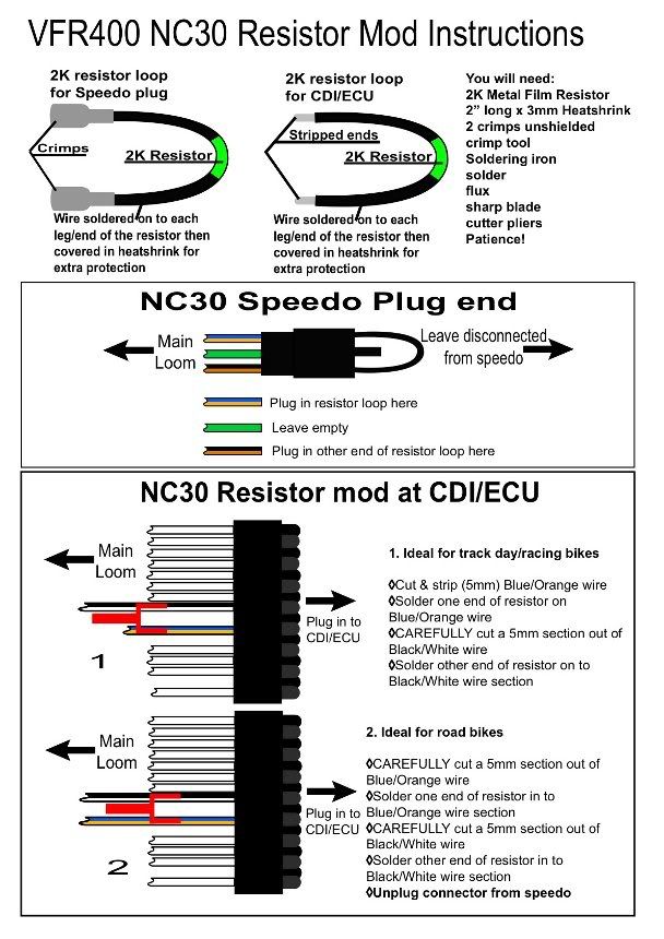

magg
- Posts: 1918
- Bike owned: VFR400
Re: regulator rectifier
Attached is bypass circuit from this forum that you can use to prove the speedo is the problem.
- Posts: 7165
Aye, bypass this - it is an aftermarket bit and has proably failed.ant75 wrote:its the little connecter behind the speedo clock ?
The speedo as a tiny 2 wire connector that plugs into the loom in the big bundle you'll see if you have the nosecone off.
