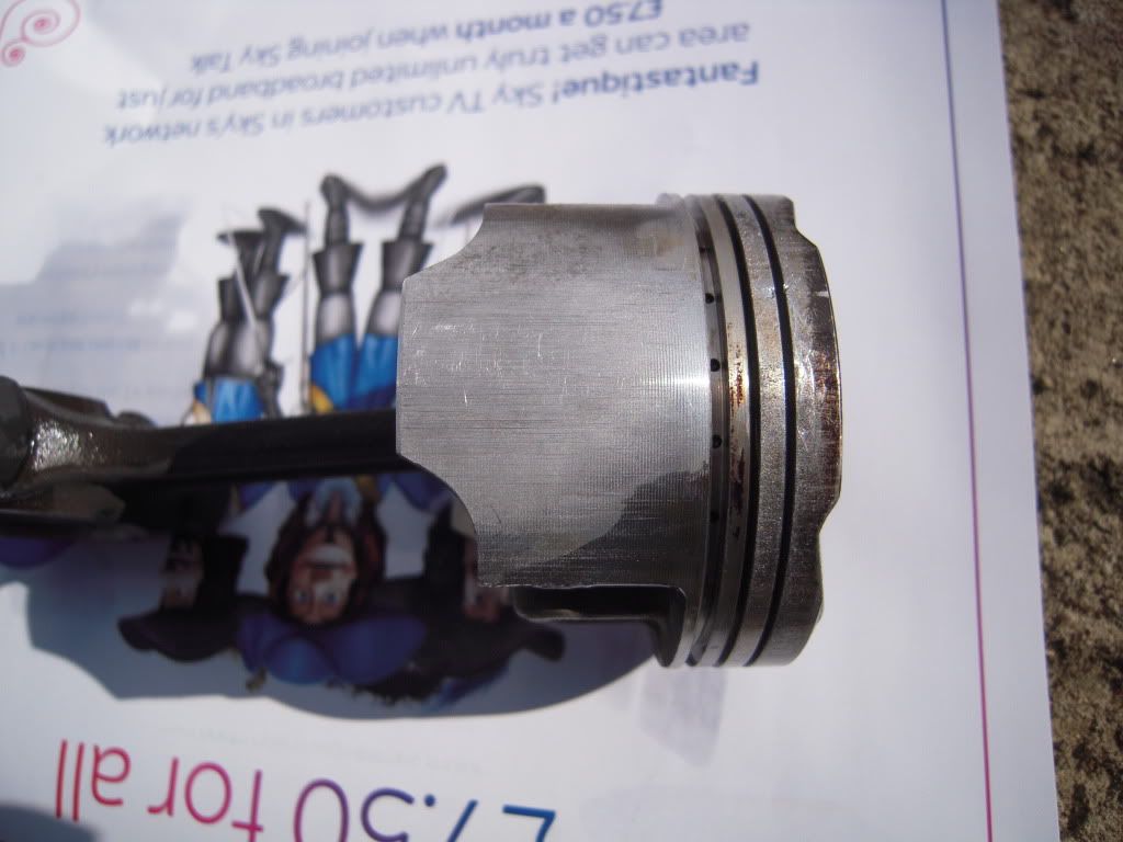

Thanks tanuki that was the last piece of my jigsaw, when i looked at these pistons today i noticed that the crown is quite high & had insets for valve clearance, then i noticed MV4 on each piston..& thought..huuumm...V4 ?? ...ive just checked the tail tray & its aslo an RR-N model !!....ill take a pic tomorrow, if someone could confirm that they are or not that would be great

Re: Help with NC29 engine needed
This is the worst cylinder
this is the worst piston
And (cross fingers) these are RVF pistons ?!..lol
