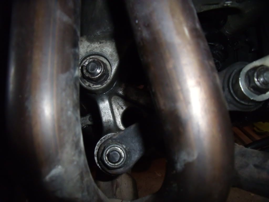

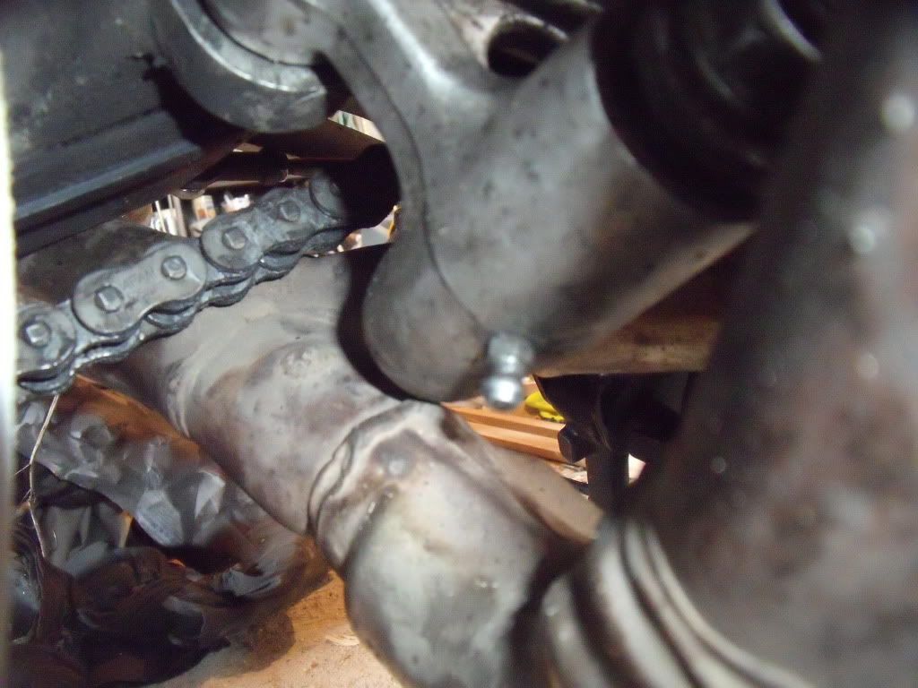

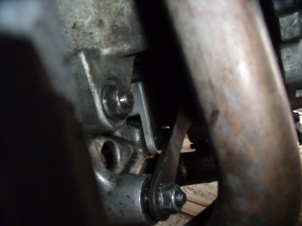

Anyway I fitted the shock yesterday, but I think theres something wrong.
The shock linkage is touching the exhaust pipes, I was wondering whether I put the linkage on wrong. I fitted with the ends curving downwards, like Haynes said. Heres a few photos, any ideas whats worng, or perhaps its because the shock it longer. But I wouldnt have thought it would effect it????

It looks like the shock is too long and making the bottom of linkage touch the exhaust, maybe he had it fitted with a non standard exhaust ? .

It is the wrong shock...but we know that. Nothing to be done about it - as long as it does not smack it too hard when the bike is not loaded?

You could always buy a new system and manipulate it so it doesnt touch, i dont think theres any play at all with the standard one. Or just take the shock back to the seller and beat him with it till he coughs up
On the plus side tho ive known people to use this shock with good results, thing is it needs revalving etc and with what you've paid already for it thats not really economical. Have you confirmed that its fitted with a heavier spring yet?

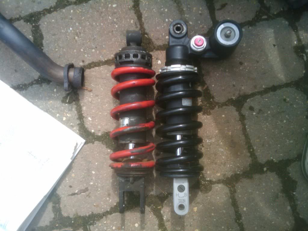

Heres a better picture, someone may be able to recognise what it is now?? I do not have an older model VFR, I had to replace it with this K modelo I think when I brought the bike

Its a K7 GSXR shock like everyone has already said. Have you rode the bike yet?
