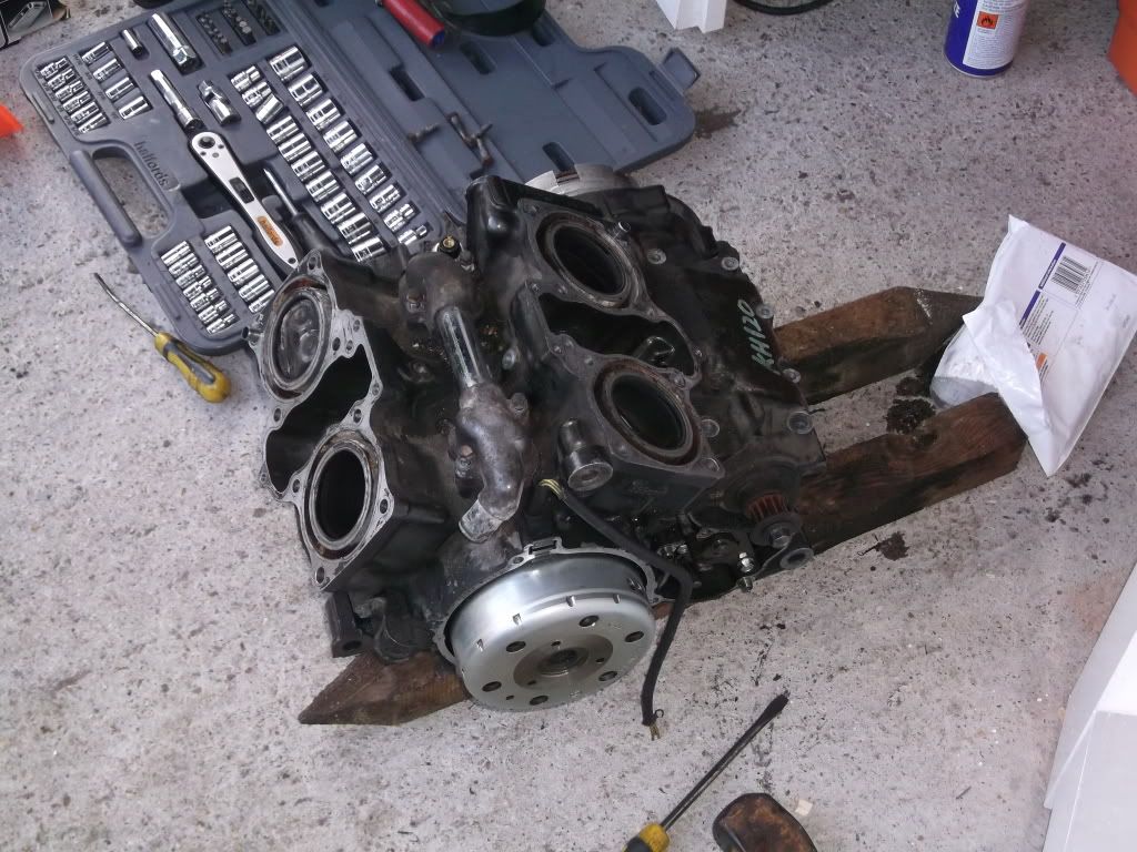

Drained the oil, was low (just over 2 litres in the sump) but healthy if grubby, no large chunks or flakes in there and it was dirt brown, not black or gold. Have refilled with fresh stuff, made sure the level was right, still clattering
Half way through the tear down, no loose shims or obvious faults, so think it's deeper, and will have the sump off to see if anything is in there that's too big for the plug hole. More info avail on request, and any help or advice willfully accepted
