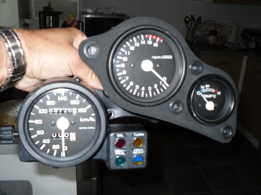

Have you guys got any advice on tidying up my speedo surround
I cant stop the clutch adjuster scratching the edge of the clock without adjusting it so it's very uncomforatble to ride.
I can't seem to find a happy medium.
Any advice? I gather this is a common issue.
Thanks in advance.
Thanks in advance.

I have my clutch perch and lever also pointing up at an unsightly angle. I would love for it to be pointing down a little like my brake lever. Is there nothing that can be done with the clock brackets to shift the speedo back a little?

my clock surround was badly scuffed, i took the clocks off then took the cover off , i put some fine grit , think it was about 400 grit wet and dry and gaffa taped it to a piece of glass and slowly rubbed it around in circles on the glass , (i put a circle of gaffa on the clock glass just in case i scratched it ) then went to about 600 grit to smooth it off a bit more i also went around the edge a bit too, it didnt remove the scuff totally but made a great improvment and it looks a lot better than it did
viewtopic.php?f=62&t=27307

So, the next question, if I manage to get the lever aligned so it doesn't touch the speedo, is there any way to replace just the top part of that speedo?
