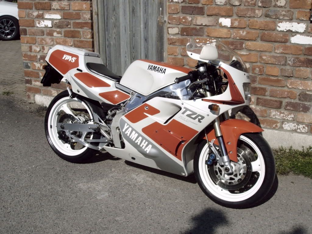

Hi know its not a 400 but thought i would share with you my pride and joy which ive owned for about 5 years now. I purchased it from a 70 year old man who has had it sat in his garage under a pile of junk for many years.
This is how it looked when i rescued it from his garage
Over the years i have been searching for genuine parts etc and turned it into the bike you see now
Updrades include,
R1 forks yokes and calipers
3ma sp rear shock
Decked and ported barrells running Tz 250 pistons
De-restricted airbox and pipes
Next on the list is to finish off a set of race pipes ive got and then just enjoy it.

That's a lovely 3MA, R1 front end looks nice on there too.

very nice,need a set of race pipes tho.

Thankyou, took alot of machining for the front end to fit right but worth the hassle
rcv4 wrote:very nice,need a set of race pipes tho.
Cheers, im on it pipe wise, got some rough ones made up to see how they fit and if all is well i will make a mint set (tig/purge) etc.

good effort,i made a set of race pipes for a 3ma 11 years back,i think i still have the patterns.Wot grade steel are you useing??? personally i prefare to tack them with tig then gas weld them,dont got too heavy with the filler wire.

Cheers for the info, they were mig welded before they were hydralic formed and think it looks crap so will re cut the sections open and tig them or like you have said gas weld as it is thin mild steel (1.2mm). Have you any pictures of your old 3ma? Bet the pipes looked superb as ive seen the welding etc you have done for Geoff in the past 8-)
