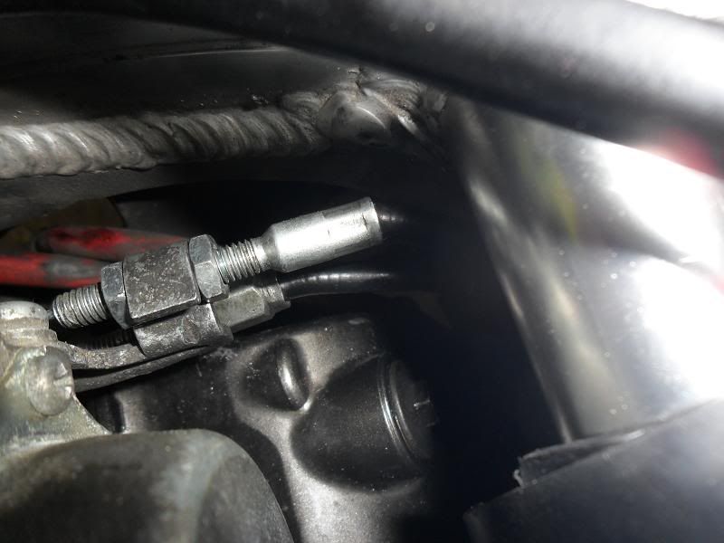

Removed tank, airbox etc to gain access to the cables at the carb end.
Double checked routing, it seems OK, although there does appear to be a bit more of a bend than I would have expected where it leaves the carb and goes through the plastic guide over the top rad'.
Probably not too clear on here
Anyhow with everything off it was slightly better
It actually apperas to be the throttle rubber grip almost binding on the bar end, when I move it up a bit it seems fine, roll it back, so there's a lot of clearance betwwen the rubber and the bar end and it snaps back more like I would expect, so it's either out with the stanley knife or go for a new rubber grip
