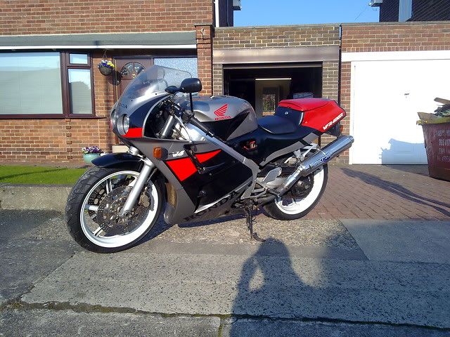

This is how it stood a couple of weekends ago;

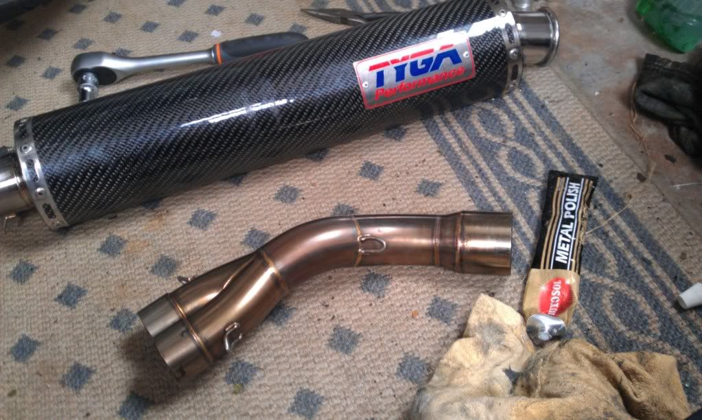

So with the exhaust studs out I though I may as well give the whole system a bit of spit and polish. The spring loaded tyga system is a doddle to disassemble. BONUS!

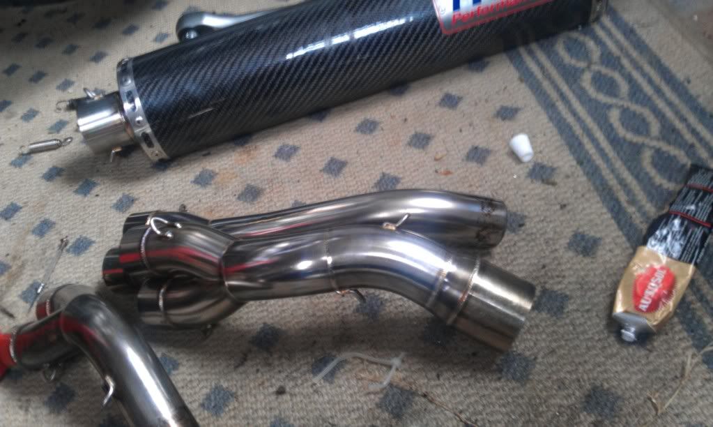

I'm not really into polishing all that much but I was quite impressed with the outcome. A bit of autosol, a dirty rag, 20 minutes, and years of being single helped turn this;
To this;

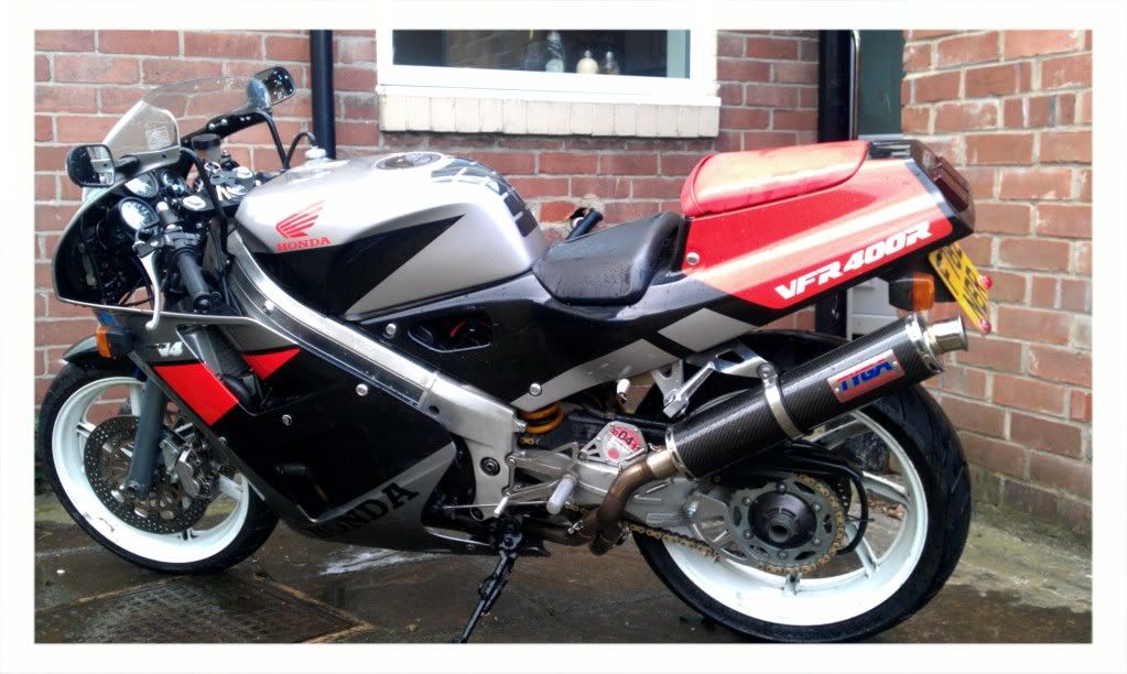

When I got the bike last year in all of its standard beauty;

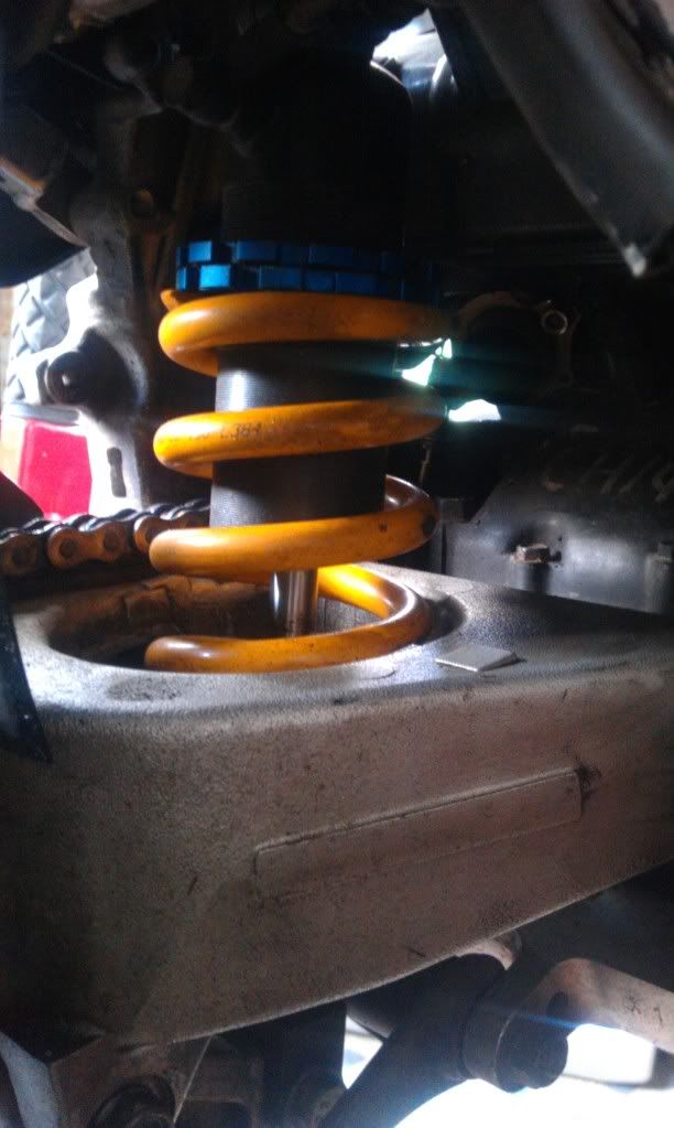

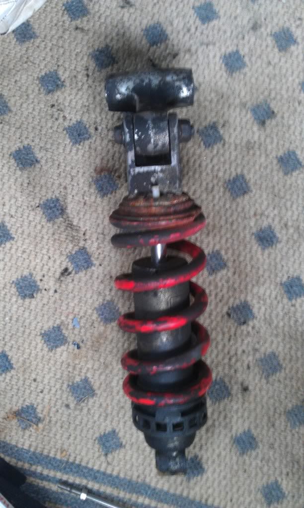

I'd thought the seat was on the low side and the shock was a bit soft so that was one of the first things to change along with the standard exhaust system. I couldn't pass on an RS250 shock that came up on here and fitted that immediately.
Not too bad for 30000km's of abuse.......
RS250 shock - Ohlins spring - Yum.

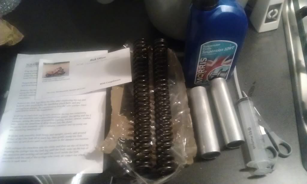

*Fit RO front end kit
