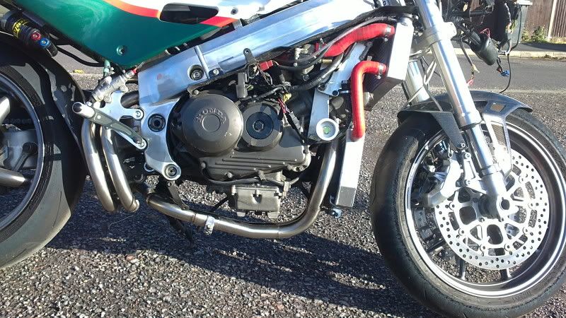

I have some non-drill type crash bungs - you can see how they mount in this pic

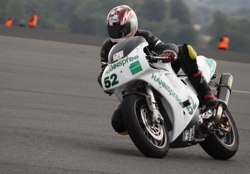

Basically there is an adaptor which lowers them so they poke through the lower fairing - as seen in this pic of my bike in its track fairing.

It does help. Seems like i have the drill type, so they fit to the engine mounting point above where the non-drill type fit!?
I was unaware there were two versions available! Bugger!
The location of the drill type results in a really awkward drill point, right where the upper and lower fairing points meet!!

the non drill ones are nearly double the price and don't fit a uk spec bike due to the oil cooler pipes location if thats what you have ? i have a set of non drill ones on an import bike i bought, the last owner dropped the bike at low speed on the r/h bung which bent the bolt which resulted in cracking the lower panel kinda defeats the purpose of having them fitted as the panel was goosed even with a bung. heard stories of the drill types cracking engine mounts also but it maybe is just bad luck some folk have with them and itype of impact .
