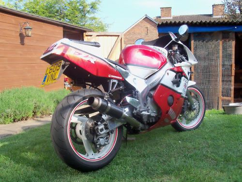

Can we have a picture of the bike ??? We like pics, but it will also help sort out what bit's you have on the bike because the 750 brakes don't fit on standard 3TJ forks ... that's assuming it's a 3TJ model.

Sussed it!!

looks nice .... it's a 3TJ model
I haven't heard of taking the anti rattle backing off pads and I'm not sure why it would be done, you'll probably need some new pads to be honest.
So are the calipers on a converter plate between the fork and the caliper ????
