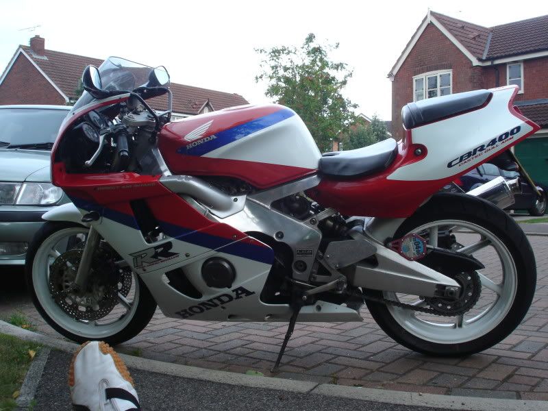

Dropped the tank
when working on the bike. I need to get it repainted.
I am trying to find the paint codes, mainly for the blue stripe the runs round the tank.
So far I have found Crystal pearl white NH 193P / A. Fighting red R-134.
Or does anyone have a tank in red/ white/ blue ?
Thanks
Thanks

Hi Grahamster, I put all the paintcodes I could find from the fiche on the specs thread, unfortunatly the stripe colour you need is one that eludes me. I have however looked in the fiche and found it is a decal, part number is 17507-MV4-300ZA, alas David silver marks it as discountinued but you may find it at other stockists, good luck.

RS paints list the stripe as a blue pearl. Never used them so couldn't tell you how close the colour actually is though.

Thanks for the info. Usefull to know its a decal.
