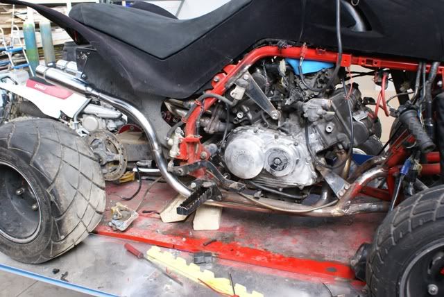

- Posts: 6
- Joined: Wed Apr 27, 2011 11:54 pm
Re: Nc30 quad
http://s1101.photobucket.com/albums/g42 ... 03.jpghere is a pic of the quad so far
- Posts: 6
Re: Nc30 quad
here is the quad so

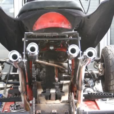

- Posts: 6
Re: Nc30 quad
hear is the back of
