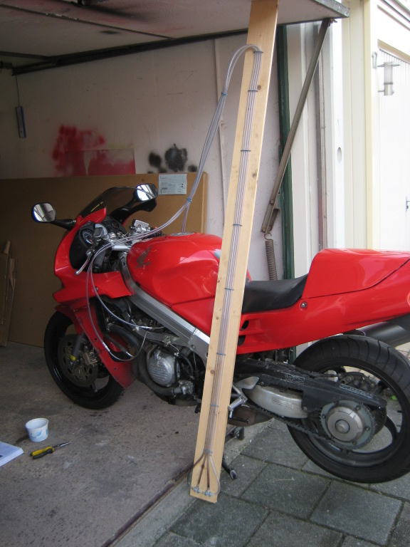

Thought this was some good initiative, I'm still wondering how to sync carbs and if I really want to have a go or not lol and through my researching I found this
: http://www.deleveld.dds.nl/carbsync.htm
(I'd just buy gauges myself...
One thing that puzzles me though is Haynes say you sync to Carb 1 on NC35's but I've read somewhere you set to Carb 2?
I'm thinking of a tool like this? - http://www.amazon.com/Carburetor-Synchr ... B004MSJ7E6
and trying to find a 90 degree'd flat head screw driver? so then i just take the side panels off and i should be able to reach everything? anyone got a picture of what the connection looks like you fit the hoses to....just so im sure and dont start unplugging random shite

Which of the carbs is fixed though? I'll have a look tomorrow anyway not gonna do anything now, it rained today and it's night now (messed up a tank pad on a 2010 honda cbf125 i owned by doing it at night once lool was slightly squiff) I'll go see how much the carb sync tool is at a shop not far way they had the gauge ones i'll see if it has a damper on it as i know the needle ones flutter a lot if i do this I've got a camera that takes massive resolution images on close ups so I could maybe write what I did, I don't see an 'absolute' dummy guide anywhere for an NC35 exactly (from fairings on to bike sync'd) but we'll see I'm forgetful, so if i do forget I'm not doing it twice just to take pics!

Re: VFR750 Carb Sync DIY tool
i made the one pictured above and my mate lent me his carb tuner and we both agreed the home made were more accurate but more fiddly to get right, because there more accurate. cost about £6-7 for the bits and just used them again to tune my bros r6.
It doesnt matter which carb is fixed as there is only 3 three adjusters (4 cylinder bike)
fit alternative fuel supply/raise tank (depending on what bike )
remove air box (depending on what bike )
raise the idle to 1800 ish
locate vaccum pipes (normally found under carbs coming out the engine block) should be blanked off during normal running
attach them to carb tuner, in line with the guages
before you go adjusting them make sure you use very light pressure on the screws other wise it will raise revs and mess it up
looking as if you are sat on bike (from left to right 1 being far left) locate first adjuster between carb 1+2
this is used to balance cylinder 1+2 out. get these level
then got to adjuster between 3+4 and adjust these level
then go between 2+3 carb and adjust 1+2 to 3+4, which should bring all four inline/level
blip the throttle
this will need to be done at least a couple of times to get it 100%
not got a clue on a 2cyl tho but cant imagine it would be much different
blip the throttle

I've just check and for some reason it's cheaper to get a better carb tuner imported from UK then to buy the cheapo one here
So I'm guessing it's standard then to have to remove loads of shit(which I don't wanna do) if you're using homemade stuff, because a commercial one provides extensions so you don't need to take anything but side panels off?
