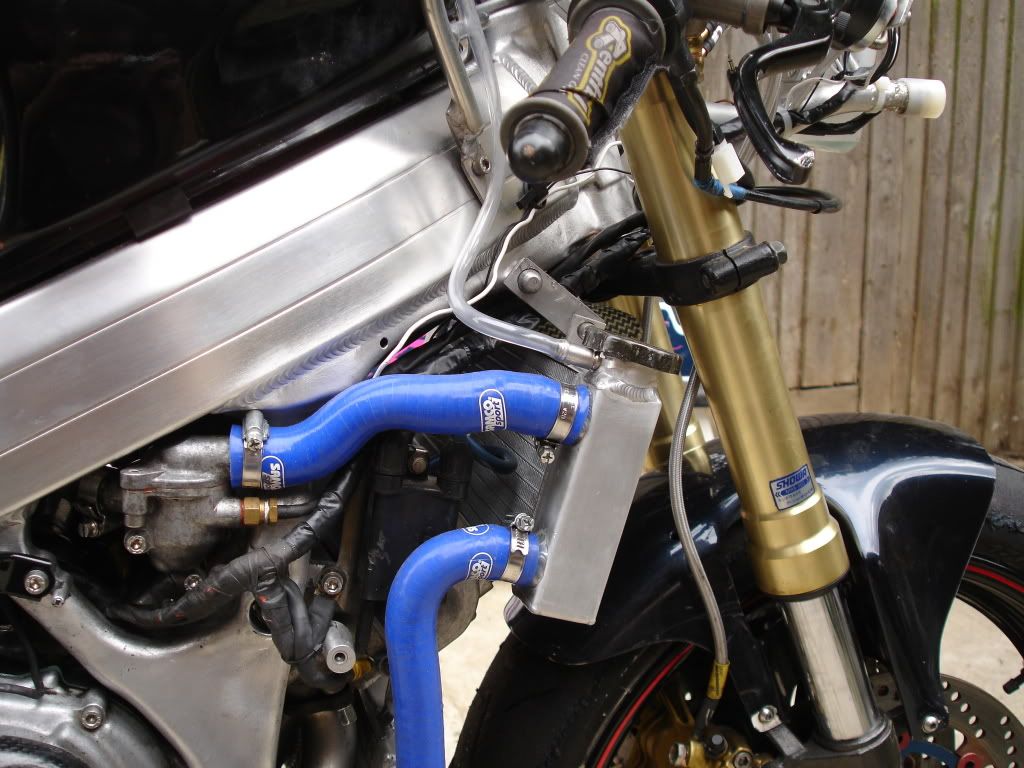

Re: RLR Race radiator - where does the temp sender go?
Temp sender with scitsu gauge
its the white wire
its the white wire
