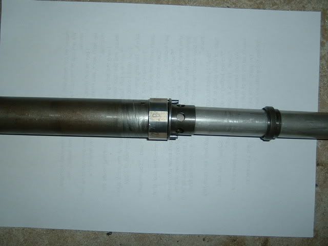

The basis idea is to retain the cartridge retention bolts in the lower fork legs and screw the cartridges onto the "studs" formed by the bolts protruding into the lower legs. I have made a tool and modified the fork spring bases so that the cartridges can be tightened from the top of the forks.
Because I am using GSXR-600 cartridges that use a 10mm thread retaining bolt, I can tap the lower fork leg holes 10mm and screw the bolts in to seal the holes and provide a stud to screw the cartridge onto. OEM cartridges would need an 8 mm tapped base plate placed at the bottom of the lower leg into which the cartridge retaining bolt could be screwed to seal the hole and again form a stud to screw the cartridge onto.
The special tool is a long tube pin spanner that locks into holes in the fork spring base so that the cartridge can be screwed onto the "stud" in the lower fork leg.
In practice it is simpler than it might sound, the pictures below should help.
The long tube pin spanner.
Modified fork spring base.
Long tune pin spanner coupled to fork spring base.
