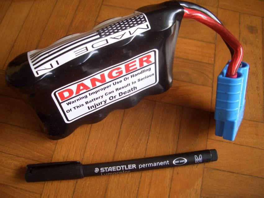

Take a look at the A123 LiFePower Pack 2.3 Ah Supermoto/400cc, cost 94 Euro inc tax.
Nonetheless, lithium batteries suffer some serious drawbacks. First, at a temperature above 70C they degrade very rapidly. Not so good in Thailand where 70C is easy to achieve under the fairing while motoring through town on a warm day. Even a hot summer's day in the UK would probably warrant careful use of air-flow and heat-sinking to avoid over-heating the battery. Second, it really is critical the battery is not run down else it will die.
