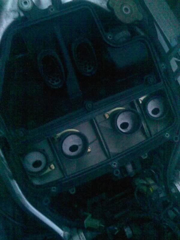

I brought some restricters from Wozza, very happy with communication, item etc :D
also Wozza, did you enjoy the curry??
are they meant to be fitted here?
if not, then where ?

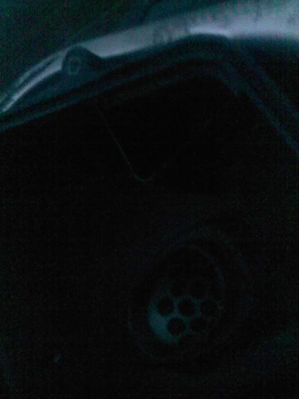

also, whats this?
would that be coolant?

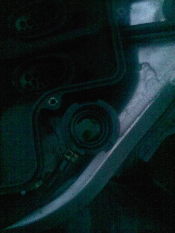

then whats this?
i have some nasty looking stuff in there and theres a pipe on connecting to it underneath?
sorry about quality it was taken on my peice of shit known as phone and it was starting to get dark
also, whats this?
then whats this?

the washers go on the engine, not the carbs

The restrictors need to go UNDER the carbs - they sit inside the inlet rubbers. Push them in as far as they will go.
Your second picture is indeed the radiator pressure cap. Well...you have the cap right?
Your last picture is the engine breather - hot air and oil vapour vents from the valve cover to inside the airbox so it will get a bit oily in there.

ah ok, so the rubbers which connect the engine to the carb??
how do i gets the carbs off, when i looked it was dark, so i couldnt really see much.. is their some of those clips which get tighter or looser spending which way you screw them?

Yes there are - jubilee clips.DK-Tandy wrote:ah ok, so the rubbers which connect the engine to the carb??
Dude if I may... you are showing potential to be one of those young owners who learns spannering on his 400. Nothing wrong with that, but be aware you should always exercise more caution than enthusiasm when fiddling with things you don't understand yet.

Make sure you take the carbs off the rubbers, don't take the rubbers off the engine with the carbs.

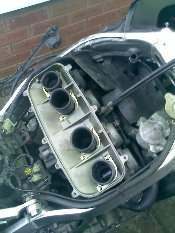

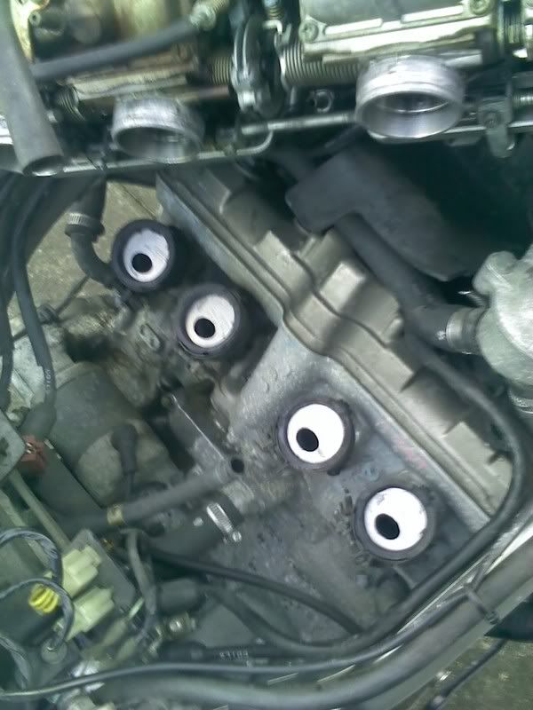

i took it all apart and got it like this
i found it rather hard to get the carbs out the rubbers.. i knew it wouldnt be a loose fit but feck me, it took alot of wiggling and jiggling to get the free.
i finally put them in, are they correct here?

Yep that's right, make sure they're pushed all the way in otherwise the carbs won't go back on properly.
Not sure if you have, but I tend to take the plate off of the carbs before removing the carbs. Carbs should come off fairly easily by rocking them backwards and forwards, provided you've loosened the upper inlet rubber fasteners enough.
