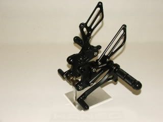

Already have a rearset from Kaneg , for which I machined new adapters to fit the NC 29

Coming together nicely, really like the rearsets. Wouldnt mind a set of those on my track bike. Did you have to machine some adaptors to fit?

your rearset looks nice. what brand are those?
