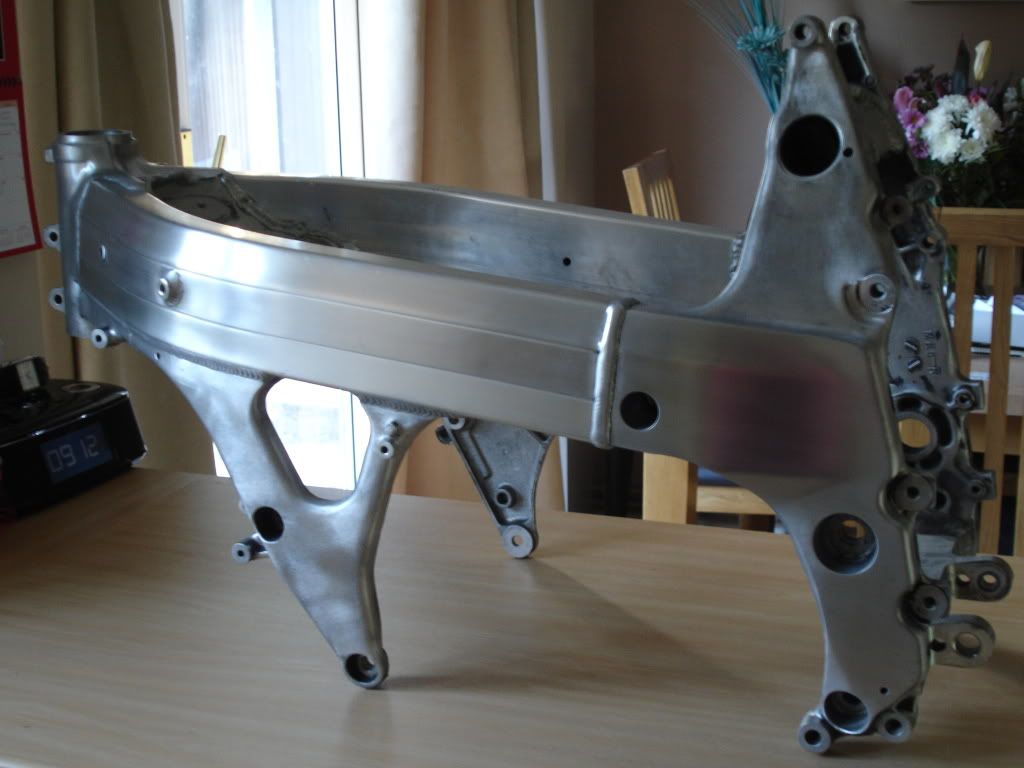

Re: Scratched frame
Polish them out then use a scotchbright pad soaked in ally cleaner to dull the polished finish to get it looking close to standard. Plenty of elbow grease needed and wont work so well on deep scratches.
This frame was covered in scratches, looks pretty decent now but to keep the finish nice could do with a coat of laquer.

Re: Scratched frame
Painting a frame is twaddle!
The scotchbright & ally cleaner works a treat after polishing
or just bang some carbon covers on there as Alex says but me, i'd just have it blasted & powdercoated.
Its a fair bit of work but looks good & well worth the effort - if you add up all the time it takes to polish it, clean it up etc & buy whats needed, you're half way there to getting it powdercoated.
& the carbon coveres cost just as much as my powdercoater charges to do a frame & swing arm!
