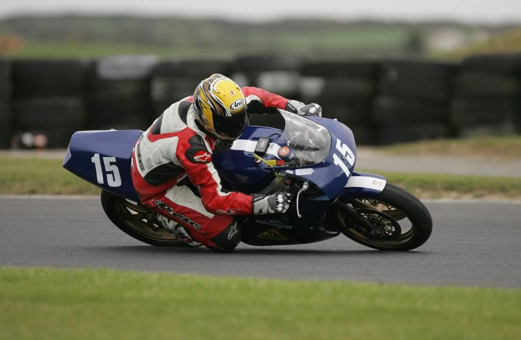

http://s752.photobucket.com/albums/xx16 ... 110010.mp4
Here's my latest improvement. Don't mind my rambling,I was distracted,not making much sense.
Pic from the Sunflower meeting at Bishopscourt. Brilliant event. I even won 25 quid....

Nice vid - I like perving on others' race bikes
Do you run no airtray under the carbs? Curious. How does it go on the track compared with the old engine sitting on the bench?
Looks like a slick bike with it's clothes on too
