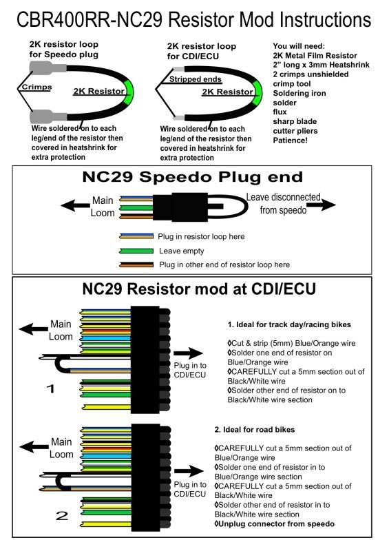

Hi Lucus, i took the clocks off this morning and dismantled them to see if there was anything floating around inside the clocks {sadly not} i tried searching many forums to find out the specific procedure of removing the metal disc inside the clocks but i cant seem to find any info.
I did however find this: [tag]http://i46.photobucket.com/albums/f115/ ... ResMod.jpg[/tag]
I thought i should upload it just incase anyone else is after the info.
Thanks Lucas for all your help, will let you know how i get on after ive done the mod.
Cheers Chris

- Posts: 1184
Re: New Nc29 owner please help
as i mentioned in PM, if the MPH restrictor was kicking in, youd NOT get over 30mph, youd NOT rev higher than 5,000rpm.
the fact that all 4 fire, then cut to 2, then back on 4 sounds more than the limiter to me. loose wires are coming to mind here.
Start with the coils, check the HT leads.
now check the MPH limiter wiring,, from the back of the dash right back to the CDI unit..
your looking for worn, cut, bare, eaten, shitty wires.
also check ALL earth points on the bike..

Thanks leopard_pagan, well so far ive tested the coils and they seems to be fine.
I tested the three wires between the speedo restriction and cdi for continuity to see if i had a break in the wires and i found that orange and blue wire was fine but the brown and black wire had continuity at the cdi on five wires {b,w y,bl bl,y g} aswell as the green wire {g b,w y,bl bl,y and light green} im not to great at electrics but can anyone confirm that having continuity at those five wires at the cdi end of the loom is right {before i start pulling the loom apart looking for a bridge or something}
Thanks Chris
Thanks Chris
- Posts: 1184
dont pull loom apart to check, just trace from one end to the other visually/feel if you can..
do you have a diagram?
i will PM you a link to the L&R model diagram.. as thats all i have, but gives you an idea.
