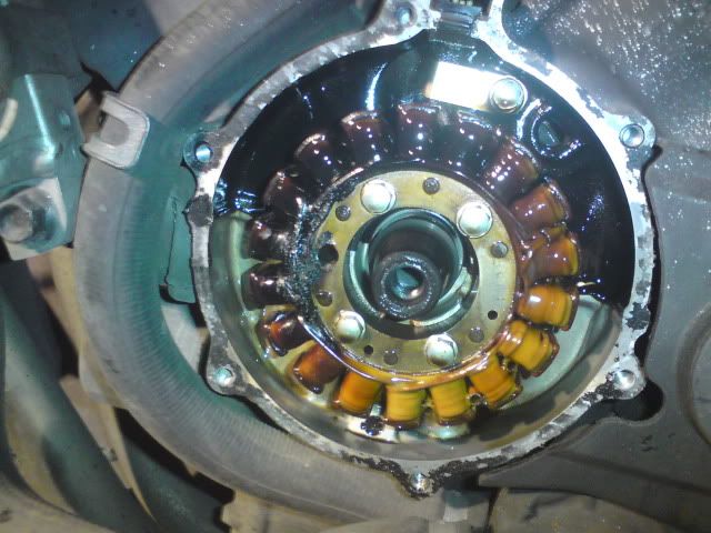

Re: nc24 stators, Which one?
Ok had a go and found this mess. looks well fecked, sorry about the delay but its been a bit stormy over here lately. and then some....lol.
- spooky
- Posts: 429
- Bike owned: nc24
Looks like its the 102 mm one as suspected so I'll order one and sort this mess out asap.
