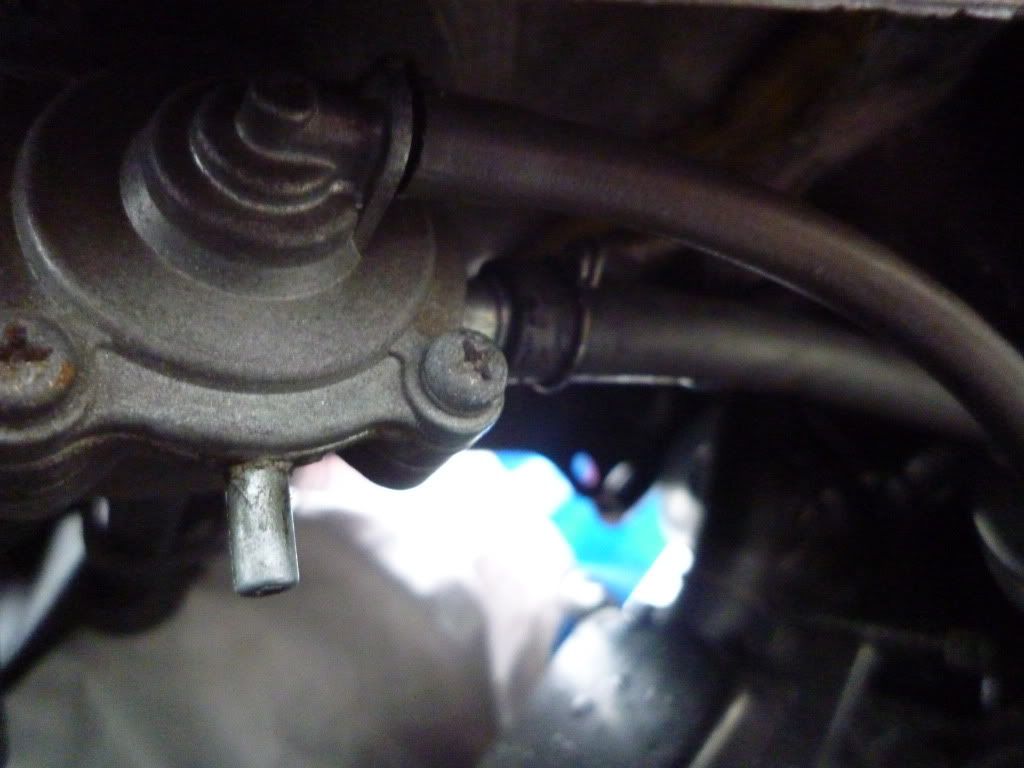

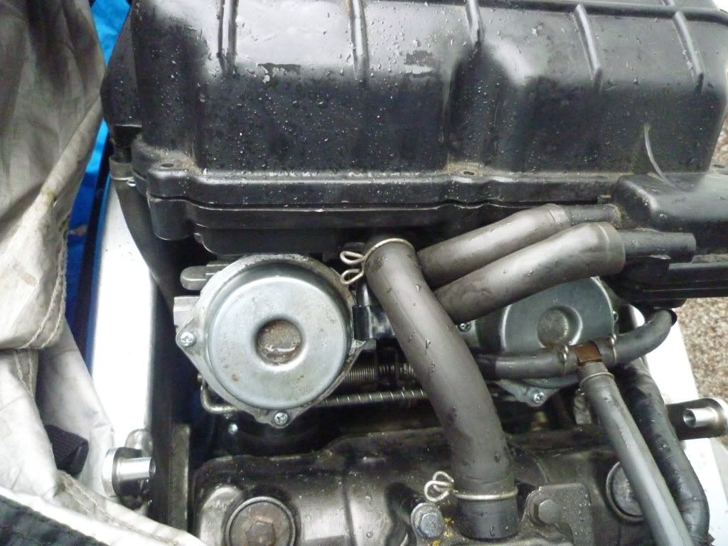

Got a few pics just to make sure I'm not missing something bleeding obvious.
Slides and needles appear ok:
Hoses all look in the right place:
I think this is correct:

Checked the carbs, they were full of fuel.
Re-connected everything as tight as possible, then did 3 cycles of 5 seconds full choke, no throttle. First time I thought it was gonna catch but didn't. Tried twice more with 3 minute breaks but no joy.
ArgH?
thunderace
Posts: 1584
Bike owned: R6, YZF600R
Location: Blackburn, Lancs.
Re: NC30 starting problems
Post by thunderace »
Are you sure the carb and airbox are seated & sealed properly?
