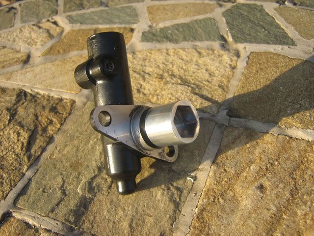

I made a few of the alloy speedo drive adaptors a couple of years ago and still have a couple left if anyone is in need ... PM me if your intersted.. but I must stress the cable and bevel drive must be kept lubed cos the original plastic one is designed to fail... after all its much cheaper to replace than the bevel drive unit....

Re: Speedometer drive problem
