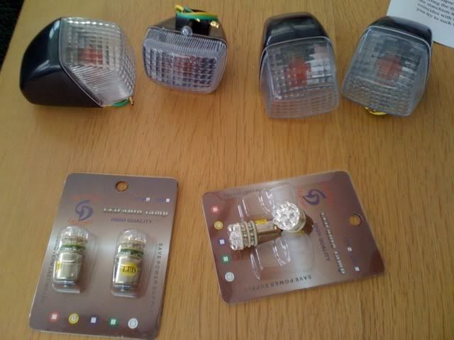

Clear indicators from Hong Kong and LED Bulbs

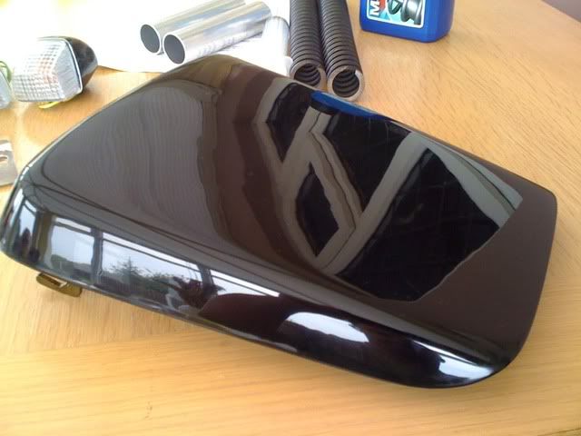

Single seat cowl, painted by my good self!
Before:
During:
After:
Cowl:
Just need to find someone to do me a new red outline stripe thingy on the rear so it carries over the top of the cowl, any ideas??
I'm really liking the new indicators, they still retain the original look yet update the overall look slightly too!
Fitted with LED bulbs inside so they now match the LED rear light. Sweet!
Before:
During:
After:
Cowl:

nice one. did you need to change the indicator flash relay?
- Posts: 229
- Joined: Tue Sep 08, 2009 9:05 am
- Bike owned: NC30,
- Location: Nr Dover, Kent
Re: Clear Indicators & Led Bulbs & other new bits (pics)
Yep changed the relay for a generic LED one, had a bit of a mare with that! The first one I got didnt work at all (duff relay) so exchanged for another, that worked but gave the bike hazards instead of indicators.
But thanks to the font of knowledge that is cammo, sussed that its the idiot light on the dash that causes the problems. Just need a couple of diodes and all will be well!
Very weird not hearing the tick-tick-tick of the indicator tho!

graham would you say that the led bulbs are brighter than conventional bulbs been thinking of replacing my stop/tail bulbs with them but most sellers say they are not as bright as normal bulbs

I found that the back light LEDs are brighter but that is a purpose made unit originally for a ducati.
The indicator bulbs are not quite as bright as normal bulbs but not enough to loose sleep over!!
