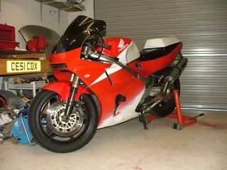

Well i have started getting the engine out, so here goes with the thread.
Please feel free to offer advice if you think i am doing something stupid
Anyway, this is how the bike looked before i got it in the garage.
It doesn't always rain in Wales
So it is now in the garage and i am just about to start to get it apart
I will add some more pics in a bit, need to recharge the batteries on the camera.
