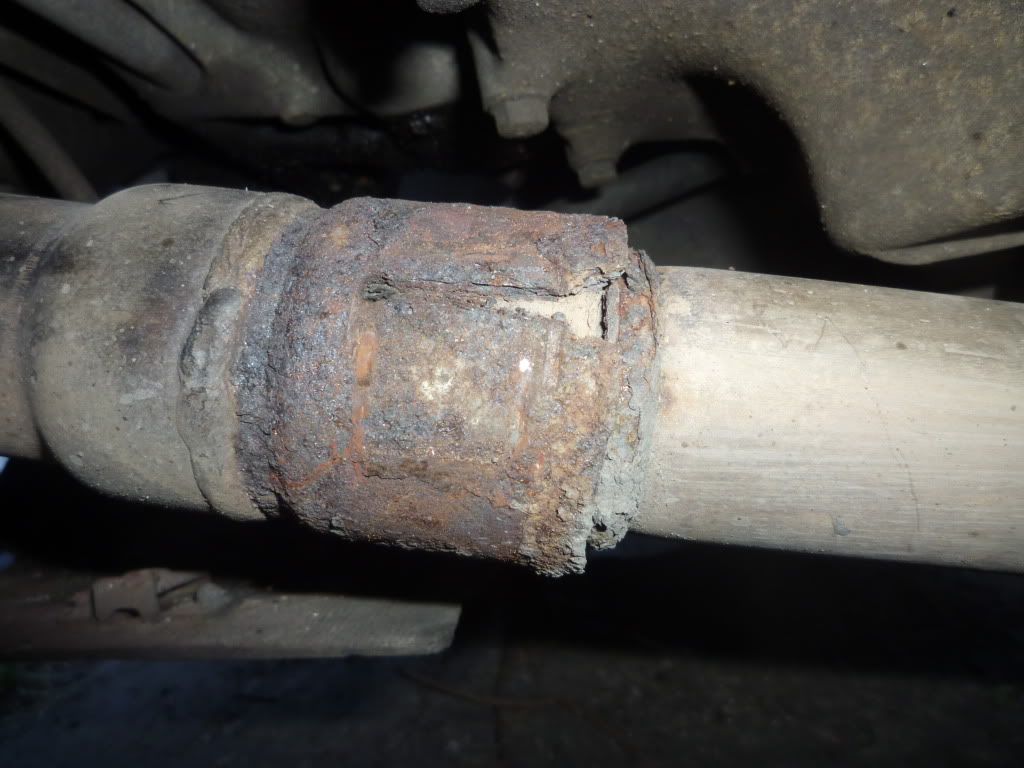

Re: Noob fitting exhaust clamps.
This is what it looks like, do you think that'll just crumble and fall apart?
If not, I assume that what I do is: take the can off the hanger, work the pipes loose and then whack the clamps on with lots of paste?
- alexwitham
- Posts: 1340
The only permanent way of getting that fixed is removing your whole exhaust system, and taking it to get some stainless collars professionally welded in place.
If you just wang some clamps around with shed loads of putty/paste, that will either fail miserably or perhaps work for a just few days. Take this advise from someone who has had 2 exhausts repaired in the past.
