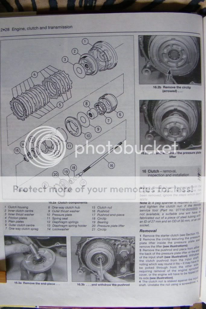

You can check this http://i530.photobucket.com/albums/dd34 ... age1-1.jpg and following pages for assembly order & procedure, if everythings in right, and its still not biting properly the plates obviously aren't compressed enough by the diaphragm springs, does the clutch lever feel very light?
