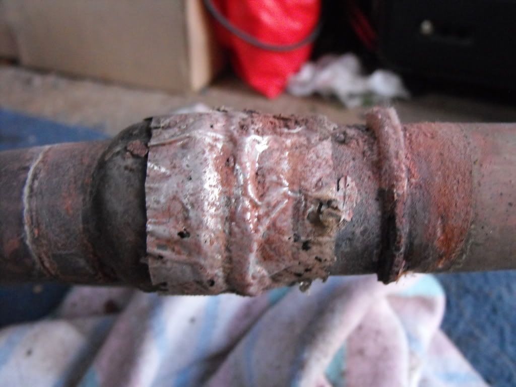

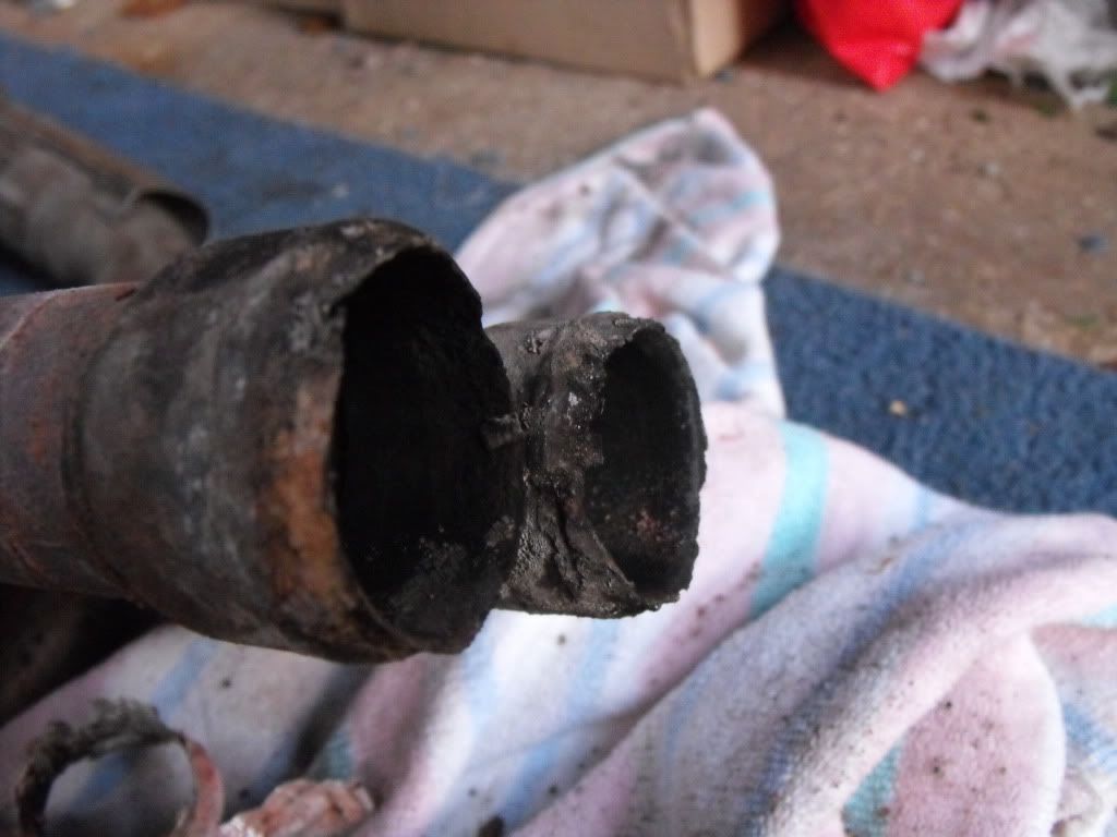

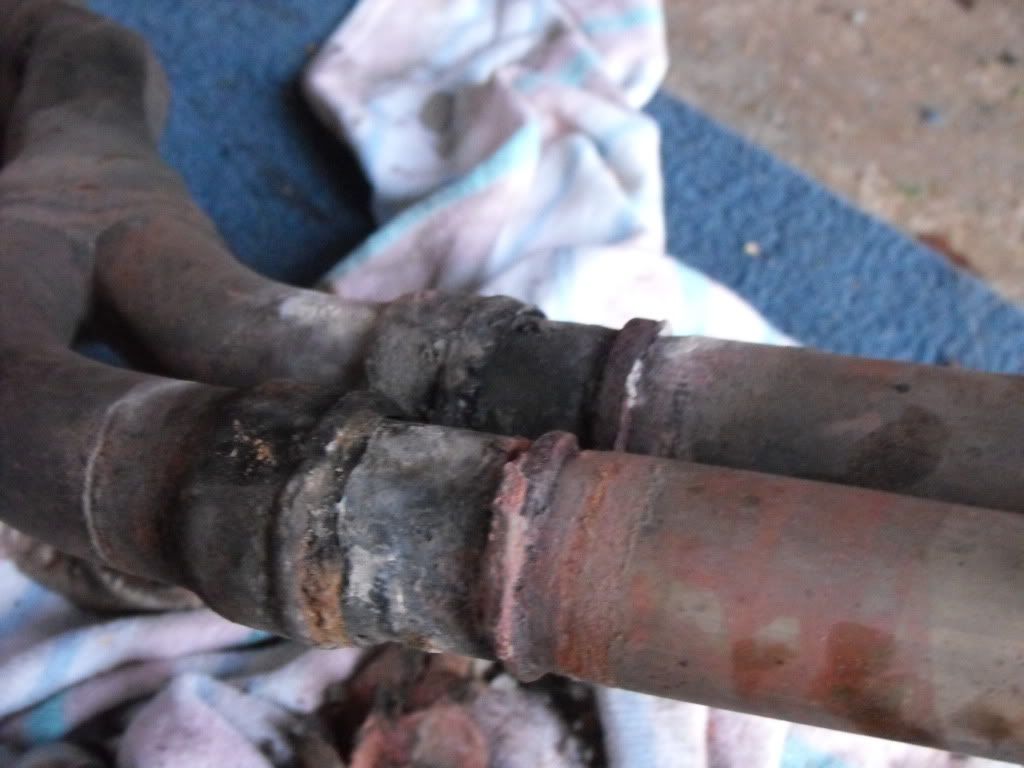

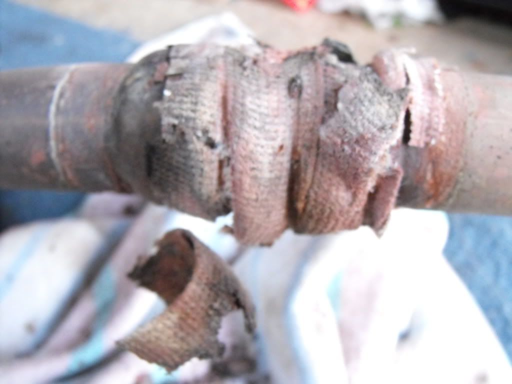

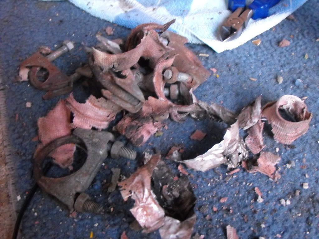

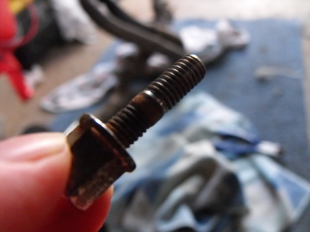

Removing the exhaust - Rear pipes, pics of collars!
Hey all, so my collars are leaking
so time to take the exhaust off, armed with my haynes manual I give it a go.
On the rear pipes, the three nuts are quite rusted! The bottom one came off fine, the middle one is awkward to get too, and the top one I haven't figured out yet.
Any tips for removing them?
